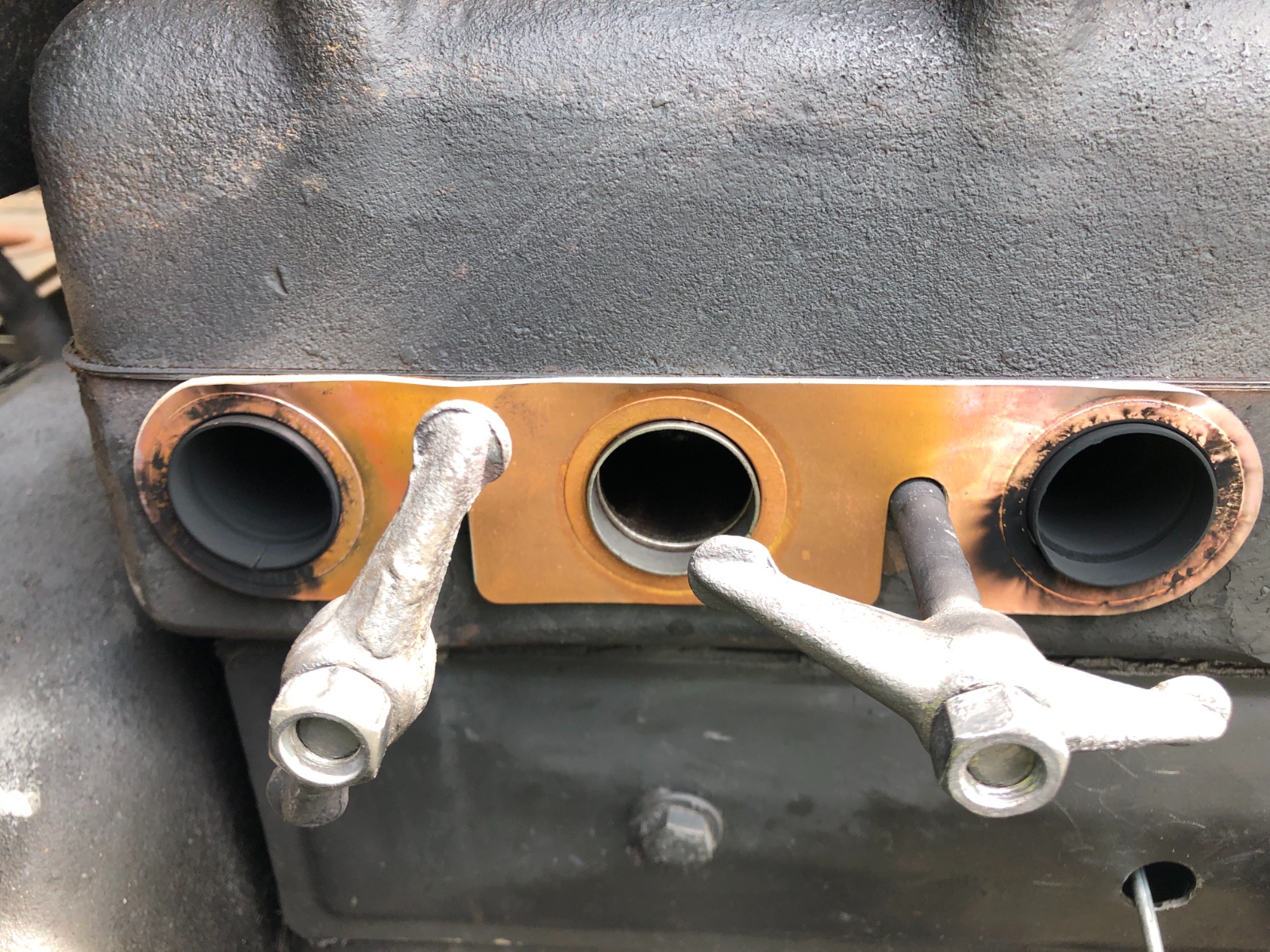

Well, I installed the U&J carburetor in my runabout this afternoon. I made the mistake of not disconnecting the exhaust pipe. So, when I removed the Ford intake, the exhaust manifold was not completely off ... just hanged there making it difficult to clean the ports for reassembly. When I went to put on the aluminum U & J updraft manifold I dropped one of the copper/asbestos crush ring gaskets and it rolled to God knows where. Whoops. Spend a good long time looking for it.
So, I used a three-in-one copper clad gasket set I had hanging on the wall for years (have never used one before) and inserted the steel glands. Once the manifolds were in place and tightened I bolted on the U & J carburetor. Whoops ... turns out you need to install the throttle rod before installing the carburetor and making that rod was it’s own adventure. It was another hour of bending and testing, removing the carb, bending and testing and removing the carb. Eventually the rod to work good enough.
Hooked up the gas line (no leaks) and the choke rods (front and dash) and proceeded to get the engine going for the first t8me with this carburetor. I started out way too rich ... but got the car started. I laid under the car and adjusted the needle until is smoothed out, though there was an exhaust leak on one gasket. Then I went under the hood and set the idle. Tightened the nuts and still had a leak but took the car for a test drive around the block. I was amazed with the acceleration. Brought the car home and decided to call it a day.
I went out to take a picture of the installation after dinner tonight and I could smell gasolene as I approached the garage! When I opened the door there was gas everywhere. The carburetor was leaking like crazy. I shut off the gas tank petcock and poured kitty litter on the puddles. A very scary situation.
So, why is the carburetor leaking? I assume it’s a float issue. Oh, while in the garage tonight I found the missing crush gasket on the ground, and so tomorrow I’ll remove the manifolds and reinstall everything. Hope I can figure out what’s up with the carburetor. A stuck float or poor seating of the needle inlet valve? So close ... but not there yet.

Here is the picture I took of the installation tonight. Thank goodness I went out there to take it.

Yes, I went through a checklist in my head and the float was high on the list. But this is the U&J that Stan Howe had just rebuilt a month ago. And when I gave the core to him it didn’t have a float so I’m assuming he would have used the new buoyant materials rather than the older hollow brass types.
I’m hoping it’s something like a bit of debris that got in there and found its way to the viton needle when I was installing the new gas line. Just went out this morning and am anxious to sweep up the gas sodden kitty litter.

Carburetors are certainly not in my bailiwick, but if Stan Howe rebuilt yours you can bet it is good.
I am going to guess trash from the tank or line. The easy fix is a fuel filter to prevent that from being a problem in the future. Lots of people have told me a fuel filter will not work on a Model T, but if they didn't work none of my T's would run. A filter will catch an occasional piece of trash from your tank getting to your carburetor. If you have enough trash coming through to block your filter you really need to clean your tank.
I put a fuel shut off solenoid on Ellie Mae because I usually park her in the garage under the house. It opens when I turn on the ignition. No problems so far, but it is still being tested.
The main problem with a fuel filer is that some Model T owners go into a tizzy when they see one, then you have to hear "Henry didn't need one", and get a lecture on how a properly installed system doesn't need one, and how they block up and the car won't run, and ethanol gas is the problem, etc. etc.
Common sense tells you that a carburetor needs clean gas to operate properly. A fuel filter is inexpensive and easy to install. And it can help prevent puddles of gasoline from developing on your garage floor.

The tank is fine, been driving this particular T for two years now with no previous problem. I did need to put in a new steel gas line because the geometry was different for this installation. So could be that. I did blow out the lins before installing.
When I put the new line in and hooked it up to the tank and carb there were no leaks. Also, the carburetor didn’t leak until I started the engine. Didn’t actually leak when running and I assume it’s because the gas was being used up quickly. From what I see this morning the leak appears about three minutes after shut down. So I’m thinking it has to be something stuck in the needle. I did give it a few raps with a small hammer and no change.
I’ll think about a filter and have no problem introducing modern improvements. But I’m sure this isn’t a gas tank problem. Ow an in-line shut off ... that is something I’ll add. Easier than getting under the car.

Glad you caught it Mark. My wife's cousin blew up his garage several years ago when his motorcycle leaked gas all over and the hot water heater came on.
Sure does sound like a needle/seat/float problem. I'd be putting my eyes on those if it were mine. Mystery trash will appear, even in a situation with a brand new carb and a tank that has never given problems in the past. If you just changed the fuel line, you jostled it around in ways that it's not used to, even with frequent driving.

Yes I’ll remove the carb today and shake it .. turn it upside down and blow air into the inlet snd see if that dislodges the stuck valve. Hate to actually take it apart as then I have to make fine gaskets. I will install an inline shut off as soon as I can find one.
In the mean time .... here is s picture I took this morning.

All fixed. I replaced the faulty three-in-one gaskets with individual crush rings and glands. See picture showing the leaks ... mostly due to the edge of head gasket preventing good contact. Emptied the carb through a coffee filter and did find some debris including a small fragment from the new gas line. I also turned the carb over several times snd shot compressed air in the gas inlet. Did a test with a temporary small gas tank from a lawn mower. Installed in the car and everything fine now.
Has better acceleration and idles ridiculously slow. I’m not getting much on the high end ... and the needle adjustment is very touchy I find.maybe I haven’t found the sweet spot.
In over three decades if driving a T .. have never had a carb leak like what happened last night. Have had float adjustment leaking and fixed that easily enough. Nevertheless I do plan to install an inline shut off on the gas line near the carb. Any favorites ?
