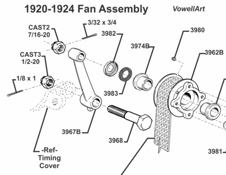

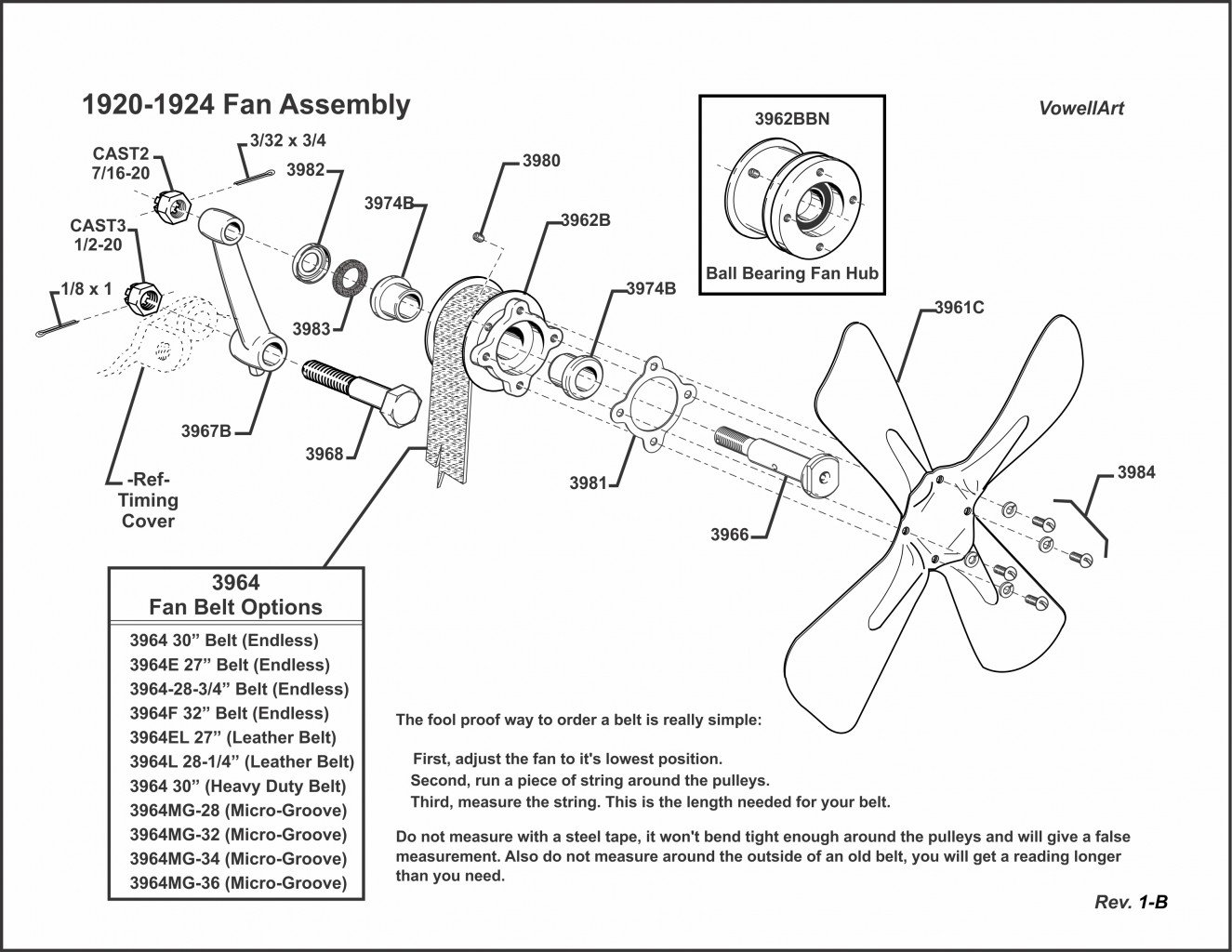

According to the judging guidelines, encyclopedia, and parts books he has the correct fan assembly on his 1919 car. The 1917 to 1920 used an iron hub, riveted blade, straight arm. grease cup style fan. I can not find a diagram for it. It has replacable bushings is serviceable and quite sturdy. The blades will still crack like the brass ones so inspect carefully.
Inspect and if all is ok then grease it up and the shaft locks with the grease cup like the brass style. I had to add a spacer between the grease cup and arm once when it would not properly lock in place and stay put.
Properly setup these will give a long life and not give the problems with the earlier brass style.
If someone could find the correct assembly diagram it would be helpful

Early and late shafts have a smaller diameter threaded section to screw into the arm. Both should be fitted to the arm, hard up to the shoulder on the shaft. If the fan is seized/tight, then the faces on the bushings need to be worked back. Then the grease cup/castle nut can be wound up tight to lock things in place.
It is asking too much of the thin grease cup centre to hold the shaft tight if it is not already tight in the arm.
