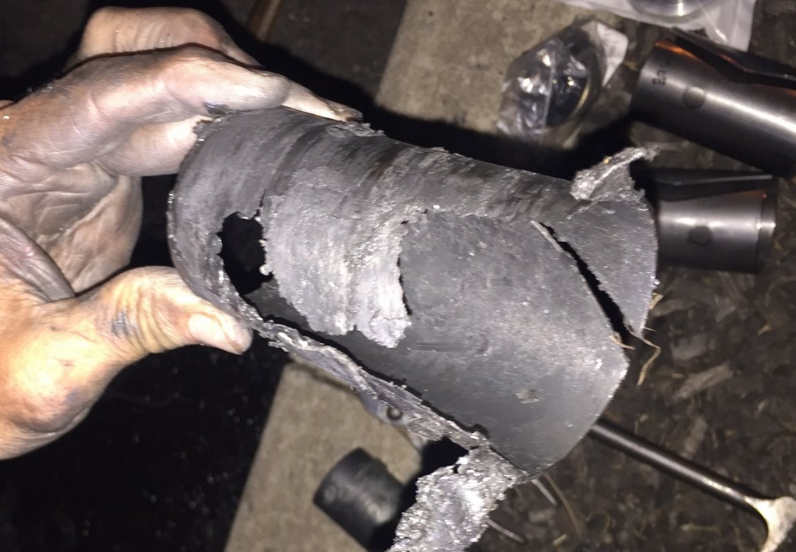

Have reports of others, who didn't check over time, perhaps a lapse of turning in the dope cups. In this example, on tour, the dope cup was gone, so unknown how long the outer ran without proper lube. Was detected on tour, noise coming from rear end, pulled the wheel in the motel parking lot.
The outer Hyatt, it was still good to use, but the sleeve was worn to smithereens...and was replaced

Whoa! A picture is sure worth a thousand words!
