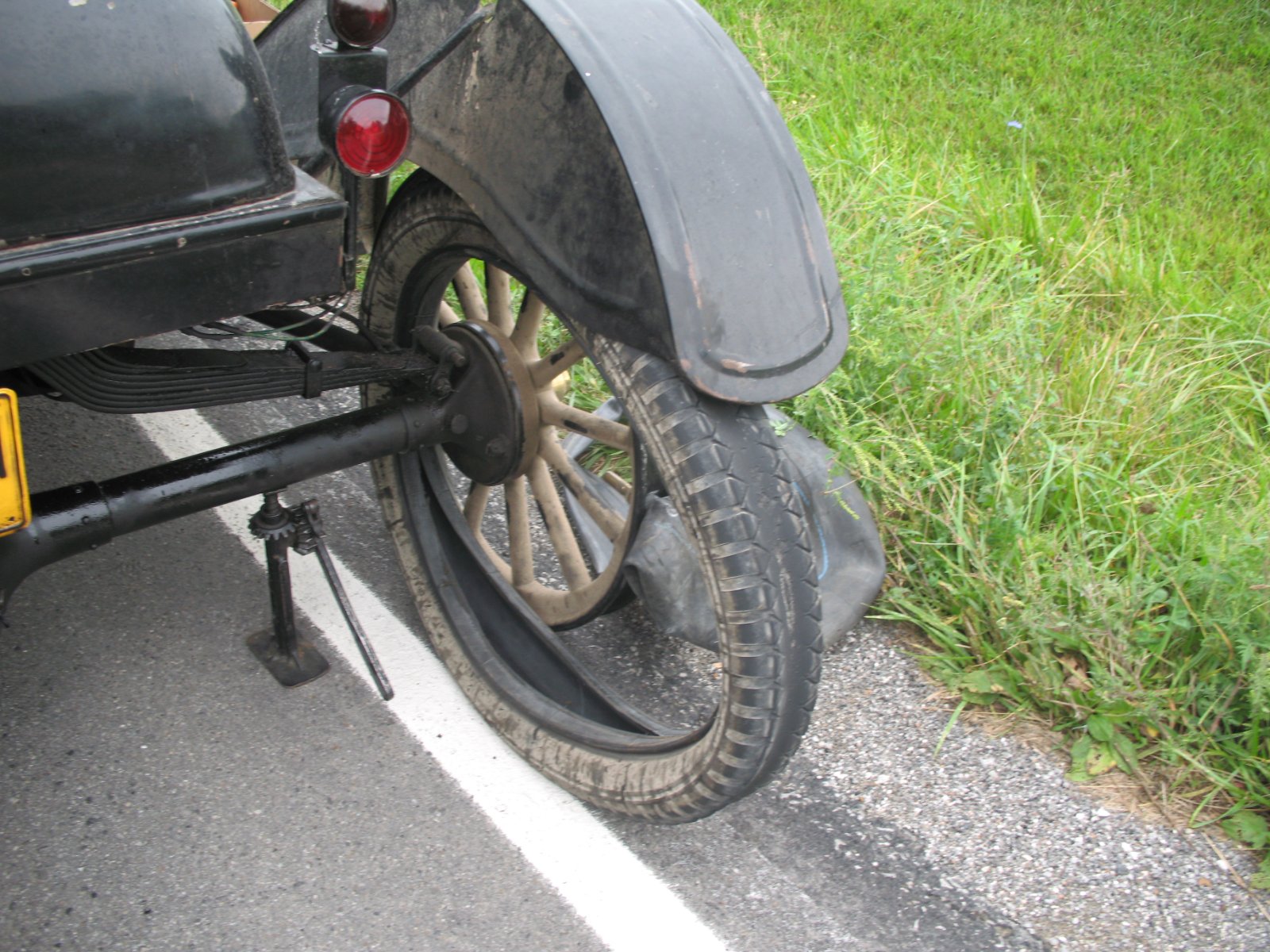

Thanks for the reply. The videos I have seen all involve demountable rims. Not saying that doesn't involve mounting a clincher tire on a rim, but I'd like to see some instruction on mounting one on the earlier wheels, (W/O demountable rim). My concern is having a flat while on a tour, or ride somewhere and having to fix it on the side of the road. I guess there is always AAA, but...
Posts: 7393
Re: DVD - Clincher tires
Post by Steve Jelf » Fri Oct 18, 2024 10:26 pm
Greg, sounds like you want a video on this kind of situation. I recommend not letting your tires get this worn. :D
Believe it or not, I would much rather change a tire in this situation than with the wheel or rim off the car.

I agree with Steve. I would rather change a tire while the wheel is on the vehicle than off. I use two long Harbor Freight chrome (slick) tire irons plus a valve stem fish tool to keep the stem in the rim hole while doing the task. A little lubricant won't hurt either. I don't want to open a can of worms but I use rim strips instead of flaps.

Fitting the tyre on the car removes the need for the clamp/s I use when doing the job off the car. The valve stem and both beads are fitted with the stem at the bottom, and the car is lowered on the jack to hold all in place. Then proceed to lever both sides on at the same time, working either side of the valve stem. If your wheels are non de-mountables, this is the way to go.

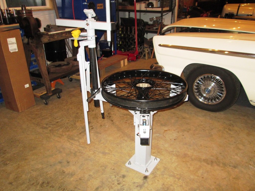

Post by RajoRacer » Tue Oct 22, 2024 11:35 am
Thus my reason for purchasing this manual machine - old knees don't appreciate the floor anymore !
