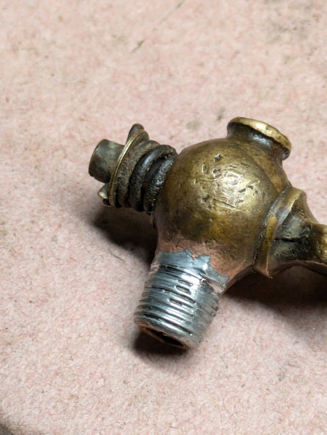

Re: radiator drain petcock is loose FIXED!
Hi all,
Again thanks for the suggestions. I fixed the problem by soldering the petcock. Three times. First time first level of solder wasn't thick enough.
The petcock spun. Second time, layer of solder was too thick The third time worked since I removed some solder. I fitted the petcock and it was tight, but I decided that a little JB Weld was extra insurance.
John
John

Nice work! Thanks for the update!NY John T wrote: ↑Wed Oct 30, 2024 9:44 amHi all,
The petcock spun.
John
