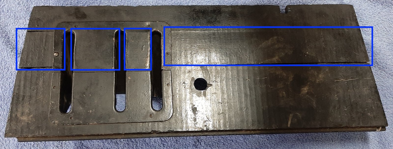

After some inspection I was surprised to find that the upper board (nº 1) is made from not 1 piece but 5 pieces of wood which are dovetailed and the riveted metal pedal slots hold them together. This shows the 4 pieces which are dovetailed to the upper piece.

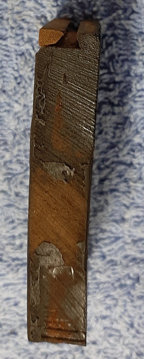

The dovetail cut can be seen here and the little piece between the reverse and the brake pedals is removed. I had to reposition it because the dovetail had broken off and was pushing it downward, making it hard to fit the floorboards in place.

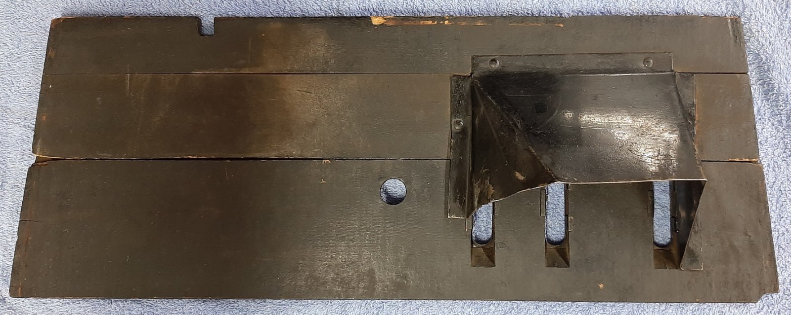

Using Jim Thode's original drawing as a base, my floorboards appear as follows:
Can anyone confirm if this is Ford original issue? It sure is quite a bit more ornate than any shipping crate could have been (reference to old wife's tail about Ford repurposing shipping crates to make the floorboards).

Ford did not use packing crates, but he probably DID use what is called a "Linderman Machine". This takes small pieces of wood, and edges them so they can all be glued together into usable wood boards. The reason I know this is that the Franklin Automobile Co, used a Linderman machine in their production, as I have found it called out several times in different Franklin Factory drawings, which call out: "Use stock from Linderman Machine" or "Make from Linderman Machine material". I was puzzled about what a "Linderman Machine" even WAS, but I finally found a picture of one on an old machinery website, with a description of how it worked.
