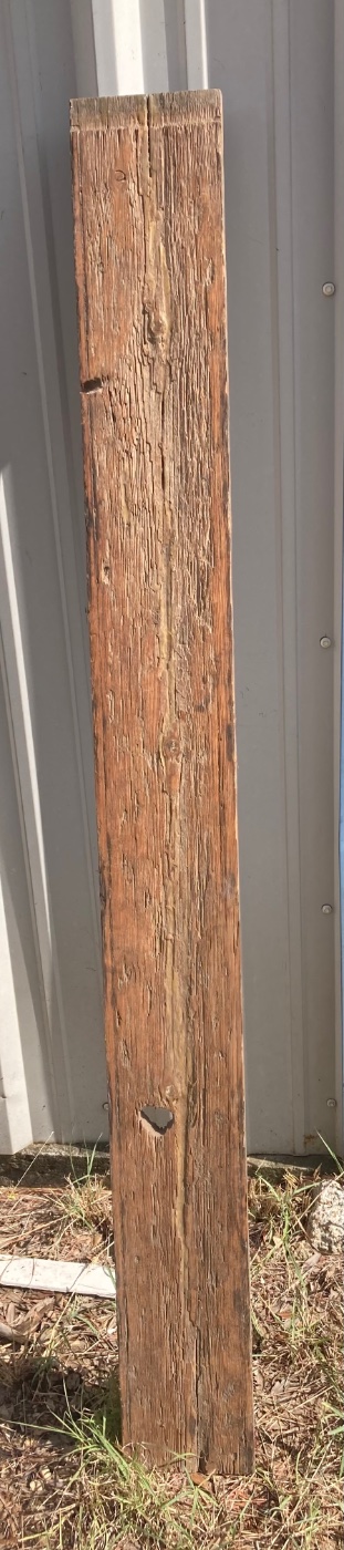

Here is a picture of an original TT stake bed wood piece. Probably not unlike those in your picture. I cut the forward section due to damage. Indeed, it’s pine. Although it’s 100 years old, the dimensions are 1” thick and 7” wide. Zoom into the top of the picture and see it’s been routed 1 1/2” to fit into the ‘Ford Truck’ last crossmember. The board will then extend to the forward edge of the front bed crossmember. The left and right boards are also routed lengthwise to fit the side panel flanges. Many, many years ago I believe I bought #1 pine 2 x 8s and went to planing and routing…..

Good info, George. I'm pretty sure mine are replacements from 40ish years ago when the last major restoration occurred. I'm looking at going back with something like Ash that will be durable but also stain up nice. Not the way that Henry would have done it but it is a show truck...
