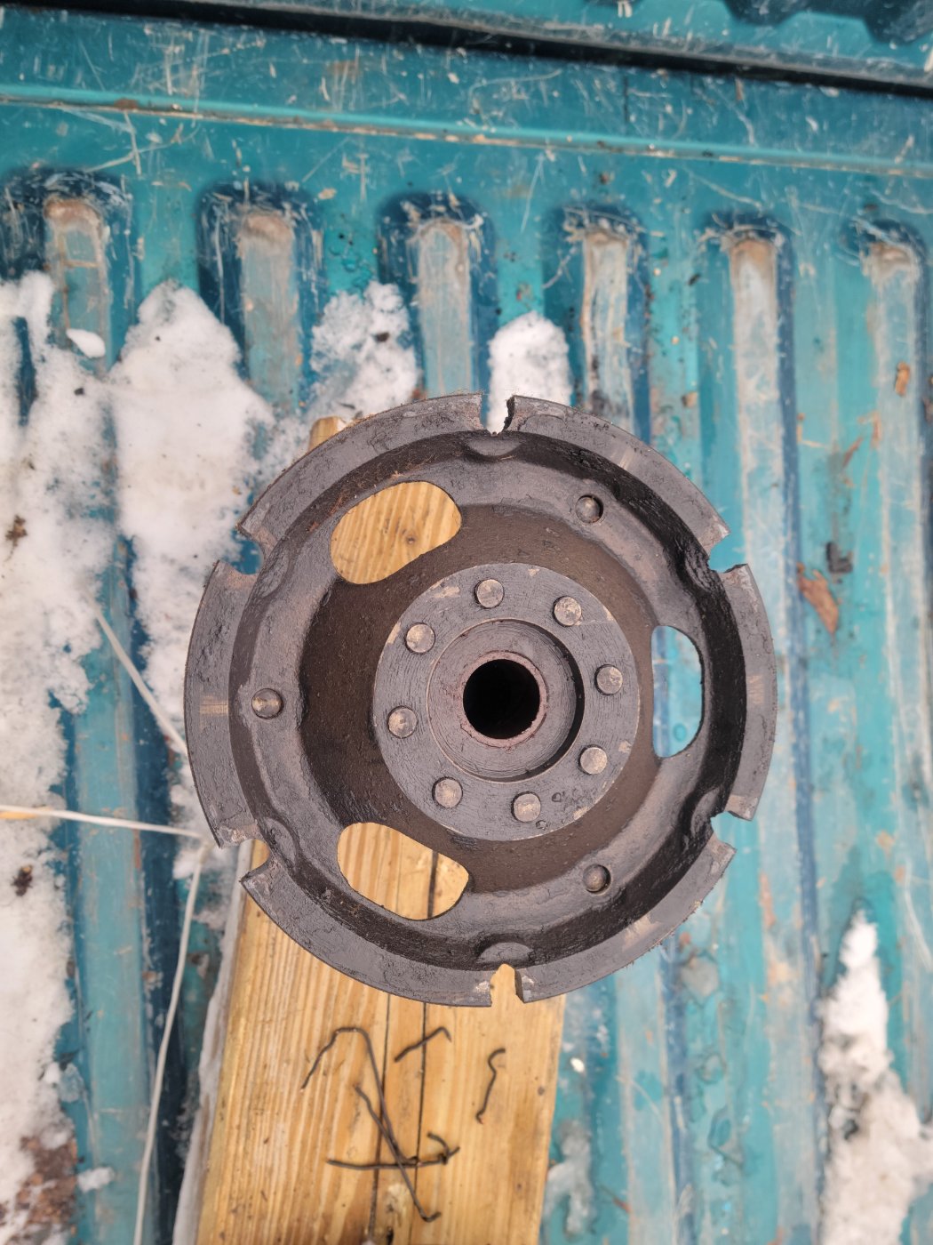

Who knows why???
Post by got10carz » Sat Nov 23, 2024 2:14 pm
Machined all the way around. Maybe 26-27 and had to much fun in the lathe?

Re: Who knows why???
Post by Dan Hatch » Sat Nov 23, 2024 2:25 pm
See if it is a narrow drum with removable shoes.
That could be one of the special driven plate we have heard of.
Kerry
Post by Kerry » Sat Nov 23, 2024 2:35 pm
I think you are right in 26/7 but not a lathe modification, but the bolt holes made over size to make it fit a narrow drum.
Post by got10carz » Sat Nov 23, 2024 2:44 pm
Dan, I've had 3 or 4 of the drums you are referring. Each 1 had a older cover with slotted holes. I came to the conclusion that there wasn't a special cover. Maybe this is 1. Maybe tomorrow there will be an answer.
Post by Dan Hatch » Sat Nov 23, 2024 2:46 pm
I think the Service Bulletins say there is a special plate, but you can oversizevthe holes on a standard plate.
Post by Kerry » Sat Nov 23, 2024 3:04 pm
Slotted holes would make it interesting, it's hard enough to get a zero run out on the drive plate to drum for the normal parts.
Post by Dan Hatch » Sat Nov 23, 2024 4:23 pm
I don’t think Ford cared about runout.
Post by Allan » Sat Nov 23, 2024 6:26 pm
Whatever, it is a bad fit-up. The narrow brake drum has a narrower surface than the low gear and reverse drums. The outer diameter of the driven plate forms part of the surface of the brake drum usually. It's not there in this application. Bad news all round.

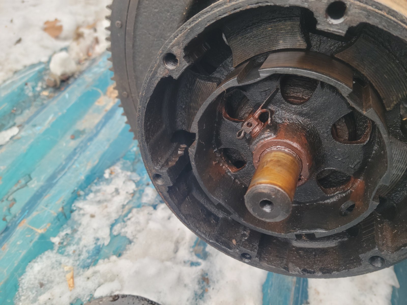

Post by got10carz » Sun Nov 24, 2024 11:35 am
No clues here. Worn clutch lugs, worn u joint square.
Post by speedytinc » Sun Nov 24, 2024 12:26 pm
Its a 26-7 drive plate with modified (larger) diameter bolt pattern.
Still usable in a 26-7 application if not for the worn out u-joint drive.
Modifying an early (pre 26) drive plate to use on a 26-7 brake drum requires the OD of the plate turned down & the bolt pattern diameter decreased.
Note the sharp edges on the brake drum. That would have chewed the edge of the band lining. As previously stated, the drive plate edge becomes part of the brake drum surface. Not obvious because of camera angle, the drum width as pictured is a good 1/4" to narrow.
Regarding run out: Not an issue If the drive plate base is square & the bushing is in spec. Remember the drive plate fits over/onto the transmission center shaft with a bushing that centers it with less than .005" clearance, it couldnt run out more than .005".
Same as the correct drive plate.
Nasty worn u-joint drive. Must have had a warford with the smaller square shaft or equivalent non OEM drive.
