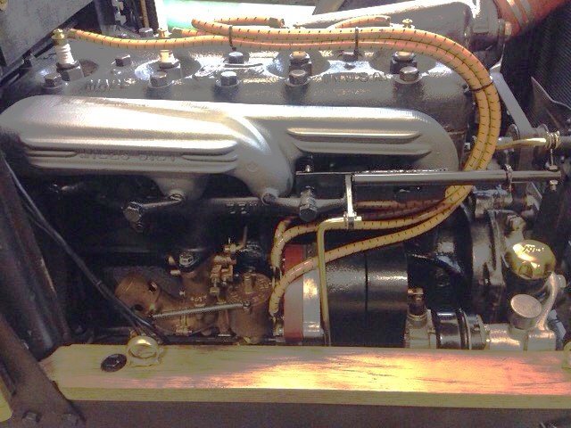

Post by Les Schubert » Fri Dec 06, 2024 1:19 pm
A picture of the intake manifold!

Post by Craig Leach » Fri Dec 06, 2024 4:01 pm
Hi Les,
I had the opposite issue when building my speedster as the exhaust bolted to the engine & the intake clamped. I used grade 8 3/8" fine all
thread long enough to clamp a 3/8' x 3/4" bar across the intake. You can do that but the of the ports on the dual exhaust manifold on 2 & 4
are greater than 1 & 3. I would think a 1/2" x 3/4" bar long enough to cover all 4 ports could be used to clamp the longer ports & set bolts
threaded into the & locked with a nut would give you the ability to adjust the hole on the exhaust manifold. It may not look pretty but if
you take some of those round corners from under the grinder & put on the bar it will improve the appearance. May not clear a early hood?
Nice manifold?
Craig.

Post by DanTreace » Fri Dec 06, 2024 5:22 pm
Neat set up, now this photo is off the forum years ago, seems good way to hold that dual exhaust manifold.

Posts: 4489
Re: Dual exhaust manifold clip design
Post by Jerry VanOoteghem » Fri Dec 06, 2024 7:20 pm
I think I would use stock clamps, but braze on an extension to the end that holds the intake manifold.
Posts: 6602
Post by TRDxB2 » Fri Dec 06, 2024 7:53 pm
Me too. Long threaded studs & using nuts for the low connections
