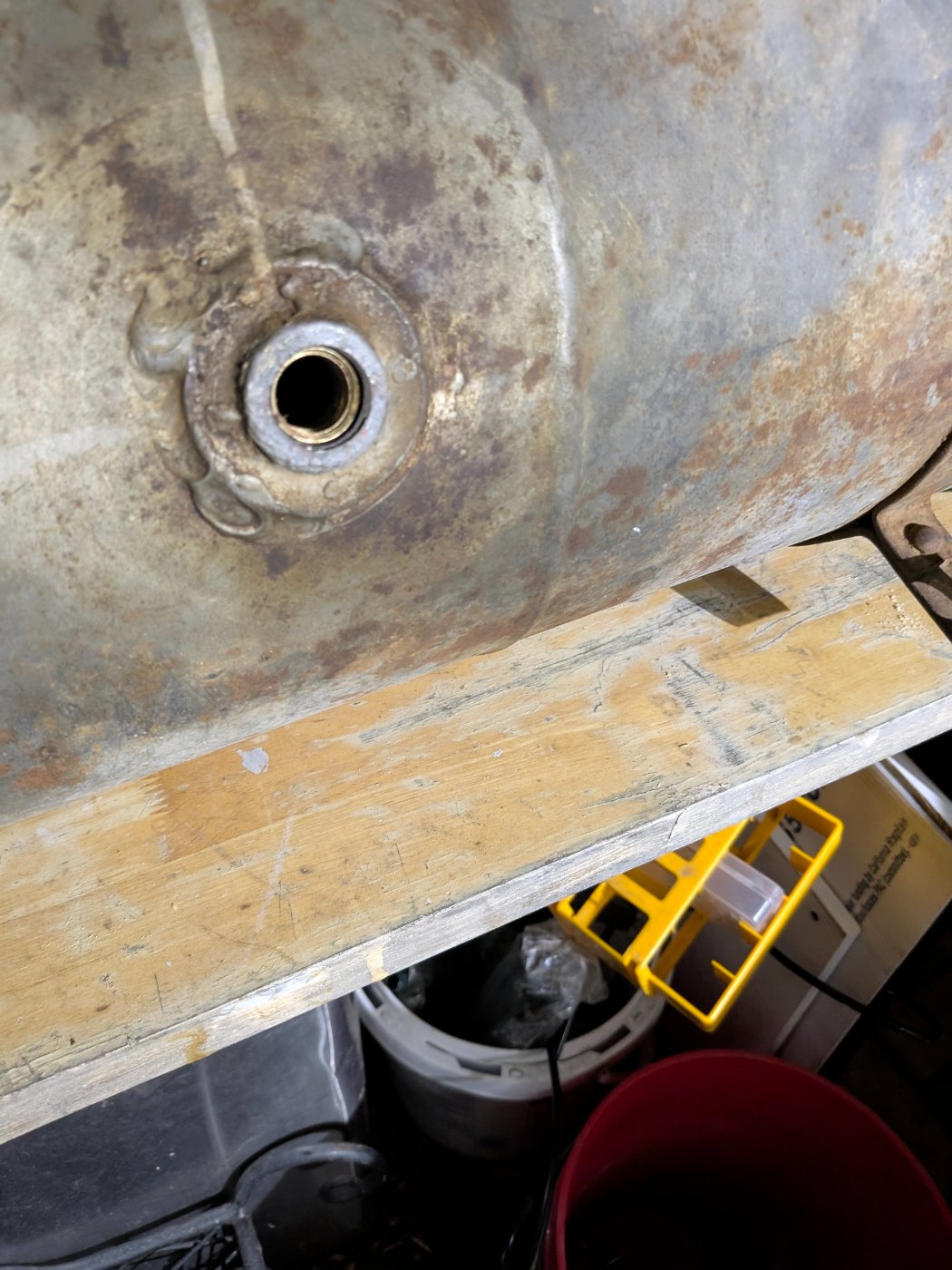

The car is a 1925 model T truck and not a TT. It seems like the bushing is threaded and no hex shoulder. The gas tank is round and fits under the seat in the current cab. Here are the pictures...

Post by Pat Branigan Wisc » Fri Dec 20, 2024 7:43 am
I have used internal pipe wrenches with good results. If it's stubborn carefully slit the bushing first

Post by speedytinc » Fri Dec 20, 2024 8:30 am
There is a broken PVC sprinkler pipe extractor tool that looks like a taper reamer.
Comes with 2 sizes of extractor ends. It will bite into your bushing.

Post by TFan » Fri Dec 20, 2024 9:10 am
Pat has the solution, internal pipe wrench. Jim

Post by Mark Gregush » Fri Dec 20, 2024 9:27 am
My solution if not removing the reducer would be to add an inline glass bowl type sediment bowl with shut off and another shut off at the carb or find a sediment bowl that fits the thread now in the tank.

Post by Jerry VanOoteghem » Fri Dec 20, 2024 10:04 am
Here's a bunch of options... https://www.mcmaster.com/products/pipe-extractors/
This one is cheap & easy... https://www.mcmaster.com/products/pipe- ... d-parts-6/
I'll sometimes file four small corners for the edges of the tool to more easily grab.
