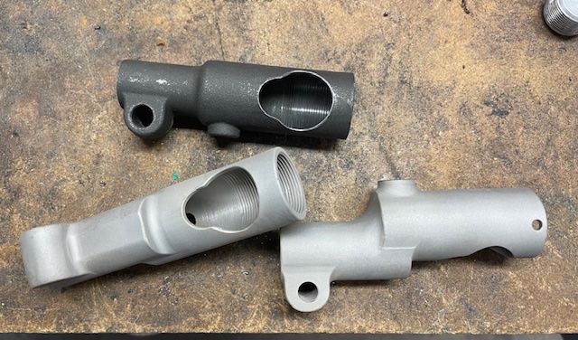

I am using model A style steering ends on my 26 speedster project, but needed to get some more clearance between the tie-rod and the radius rods. The most elegant way to do it was use an offset tie-rod end. I didn’t find what I wanted so I made them out of a bar of 4130. They use the standard model A innards and give me 3/8 additional clearance. I think they came out pretty well. I still need to split the lug so I can tighten them on the rod then black oxide them. Here are a couple of shots.

Re: Made new speedster tie-rod ends
Yeah, they came out ok. I am waiting for slitting saw for the mill and the black oxide solution to finish them up. This has been a really long running project (I started it back in grad school 20 years or so ago and I am looking forward to getting it done. It’s going to be a mahogany skiff body car so there are a lot of custom parts.
