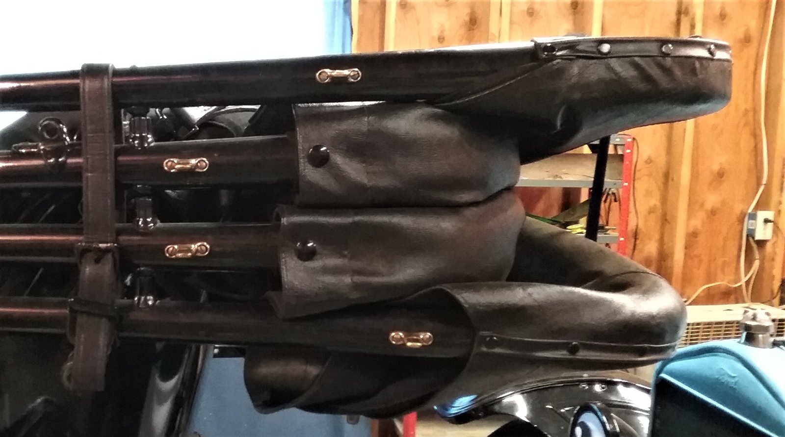

Post by KWTownsend » Sun Jan 05, 2025 7:28 pm
Yes.
When the top is folded down on my 1911, bows #1 and #4 and even and #2 & #3 are even.
When the top is in the up position, the total vertical height of bows #2 and #3 are even.
Take your time to line up everything.
I made this pattern for a top boot. Mike at Classtique made it for me and has the pattern.
-Keith
