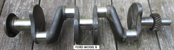

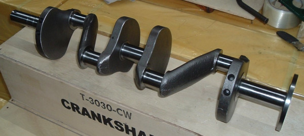

More like a Ford model B than a Sure Mike.
Posts: 5474
First Name: Henry
Last Name: Lee
Location: South Pittsburg, TN
Re: New Crankshafts
Post by Henry K. Lee » Mon Feb 03, 2025 1:16 pm
Mark B.,
Nice design! Looks better than a Sure-Mike and more like an early Chevy!
