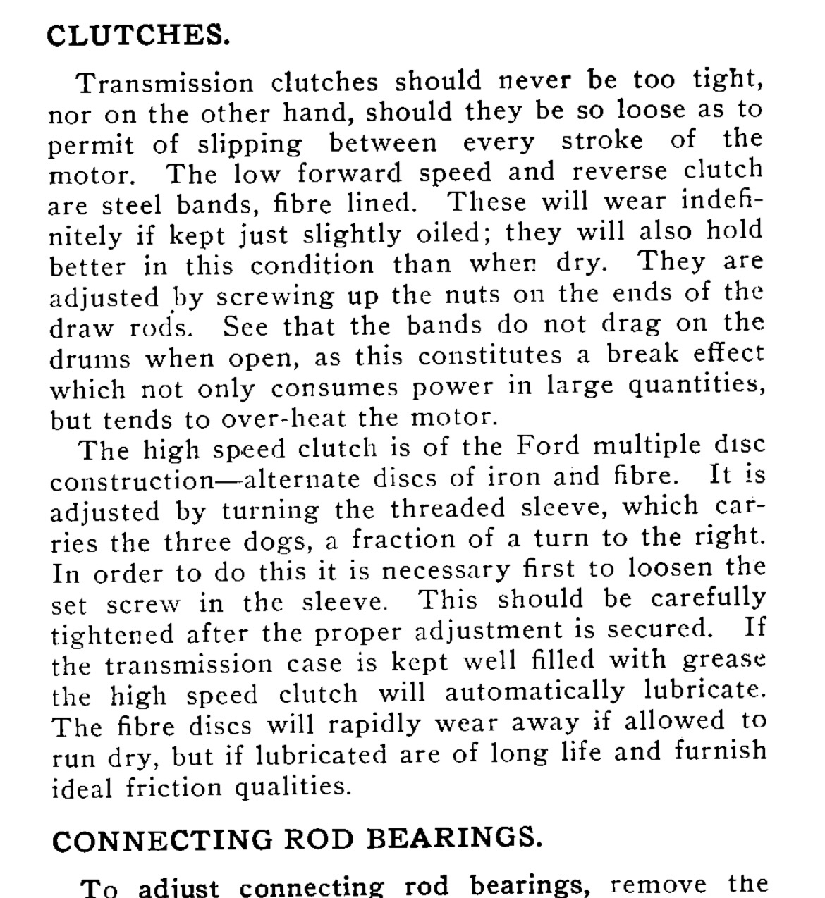

Re: 1907 Model R Ford
Post by DanTreace » Mon Jan 13, 2025 8:52 pm
‘07 Instruction book here:
https://search.app/cUbzqk5PFNxcKLU59
Page on adjusting the clutch bands.
