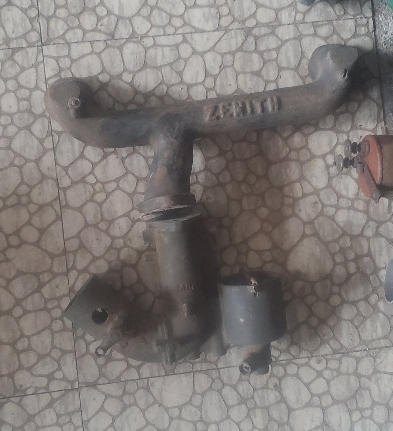

Re: Aluminum intake manifold
I thought I had it made with the one I found but the carb flange is the wrong way

- Posts: 5439
I was told in the past that the Zenith manifold with the lever on the side was the reproduction and the one Karl shows is the original because the carb Karl shows is the original type that came with the manifold and use the original Ford style carb rod.
Zenith made carbs with the bolt pattern both ways. The O4 Zenith bolts are inline I have one just like the one Mark posted.
Yes the carb is on backwards to show the model # But this may be a aftermarket manifold that was referenced because the word Zenith
is different than most or could be a later production??
Craig.
