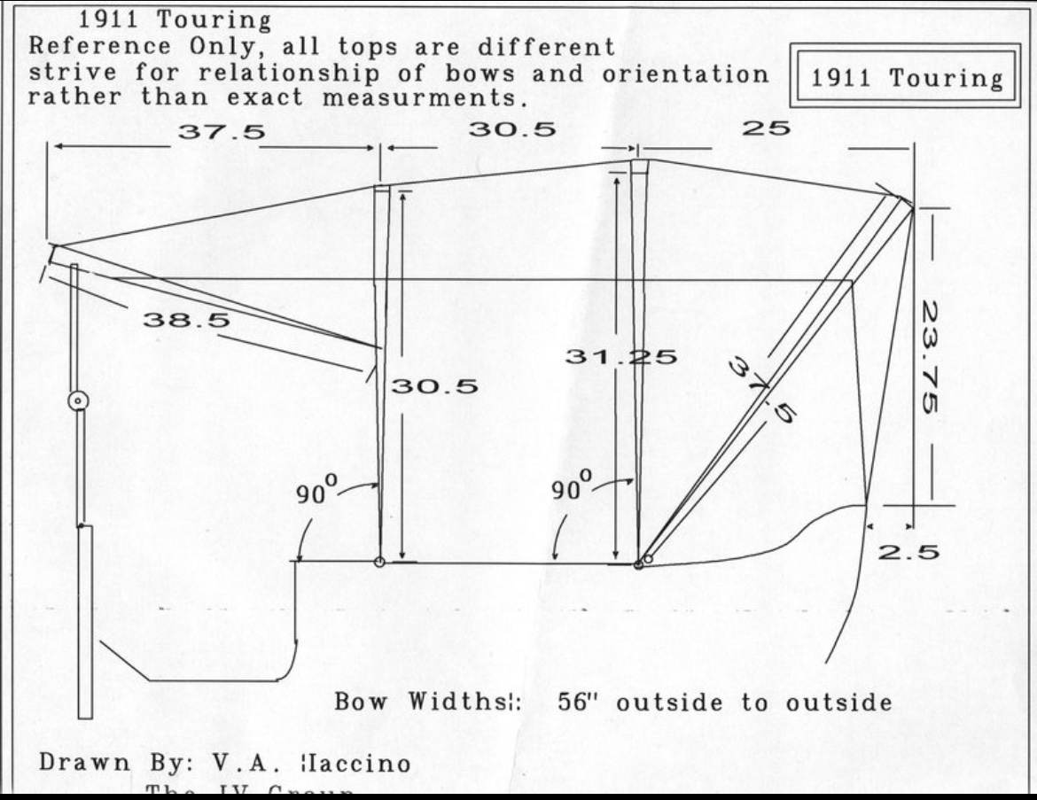

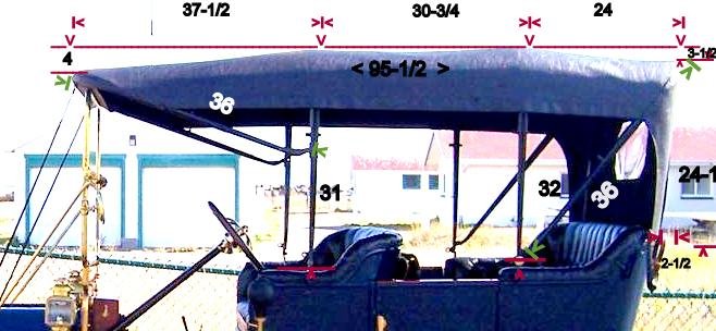

Hope these help:
These are the dimensions on my top.
Note the vertical bows should be close to the same height.
-Keith

I just saw the attachment Keith sent. That nailed it exactly
