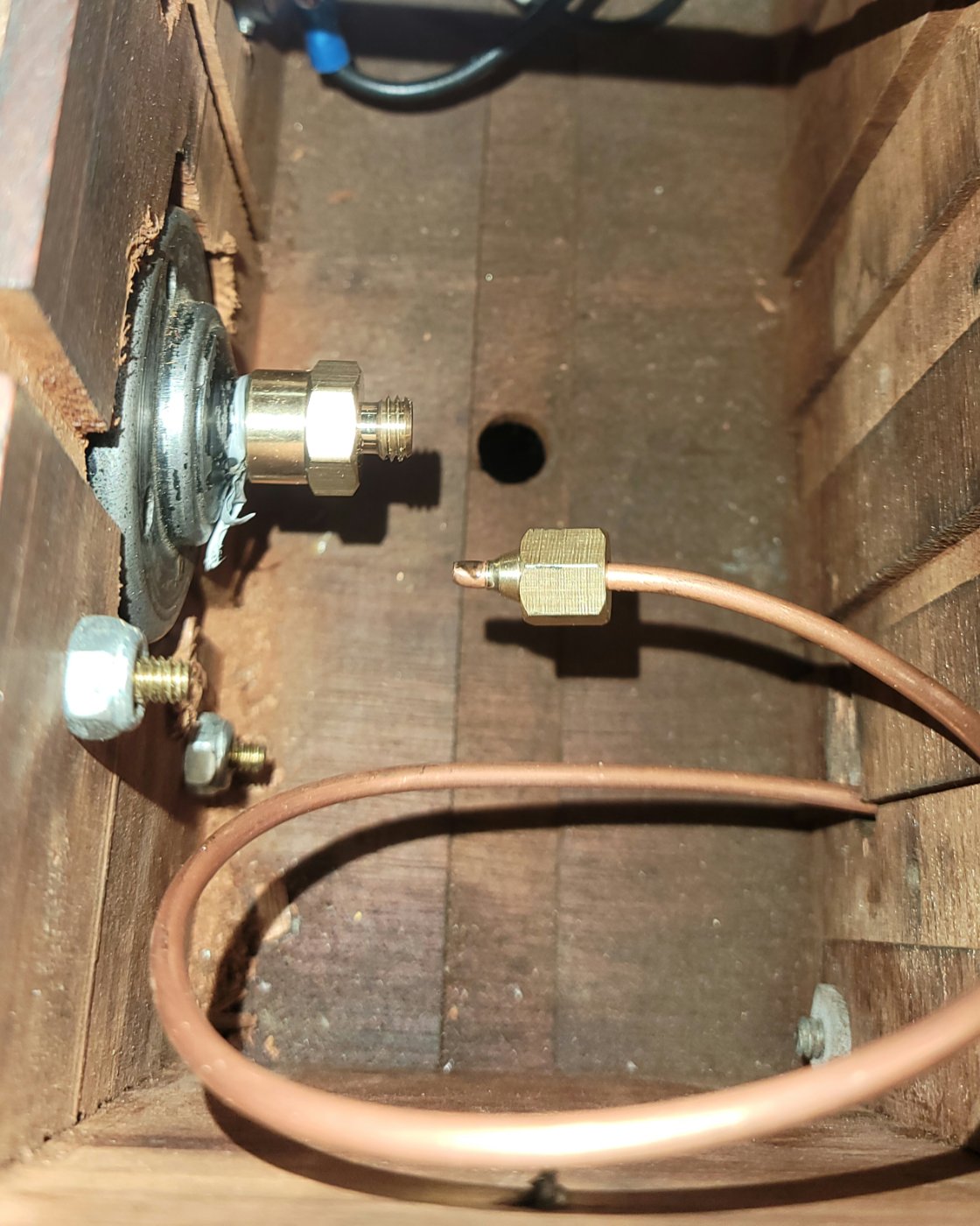

- Posts: 1469
- First Name: Keith
- Last Name: Townsend
- Location: Gresham, Orygun
Re: Oil pump pressure
Update pics...
