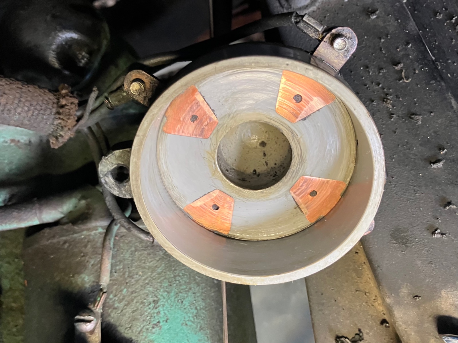

This one is a new one for me. “Best” timer. It appears to be exactly like the Nu day. Anyone else seen these? Know anything about them?

The plastic body is too soft. They dont live long.

A better name would be "worst" timer. The cap plastic is so soft it quickly wears out. Replace it with a original or recent production New Day. DO NOT replace it with the infamous "S" cap - they also wear quickly and sit a little "proud" causing the fan belt to cut a groove into the outside.
Best-look at the plastic debris Fan belt cuts

The timer you have is made from a plastic material that's classified as a thermoplastic. It was most likely made by the injection mold process. The base material is the type that can be molded, ground up, heated and remolded. Kind of like a hard wax. Since it is susceptible to heating and molding, it dosen't do well attached to a hot engine.
The original New Day Timers, and the recent reproduction New Day timers are made from a material called phenolic, or by the trade name Bakelite. Named after it's inventor, Leo H. Bakeland. This material, while formed in a mold, goes into the mold as a powder and forrmed under heat and pressure. Once it is molded, it cannot be re molded. This form of plastic is extremely heat resistant making it the perfect material for items such as timers. Beware the light colored tan timers with a large "S" molded into the face of the timer. They will melt or fall prematurely.
These tan colored timers were made years ago when nothing else was avalible and there was an attempt to reproduce New Day timers but, unfortunately, the material selection was incorrect.

I’ve got one of those also. Picked it up at a swap meet somewhere. Mine has a significant amount of wear.
