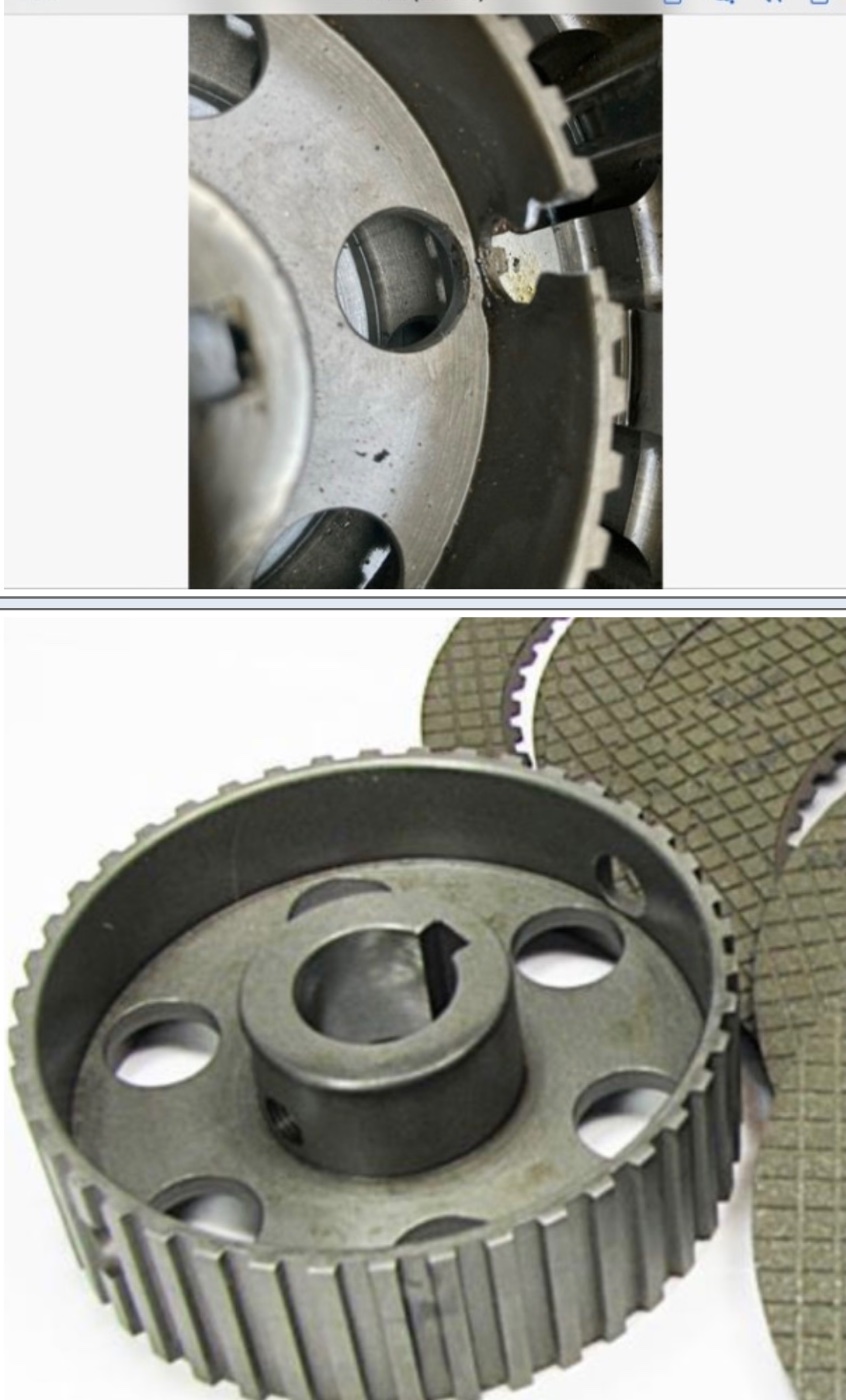

Dan, thanks for the photos.
Now, I only have to find one that is for sale!
There are plenty of the related disk packs anyway.

I see from the pic that the material used on the Jackrabbit clutch has changed to the same as the Turbo 400? That may make some more
comfortable with them. I have years on the cut down Turbo 400s with no issue I even put them back in after breaking a low drum.
Craig.
Craig.
