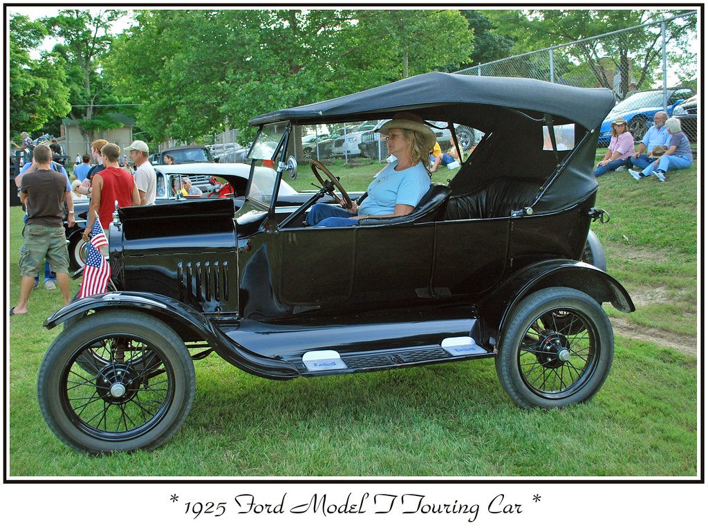

This sketch and picture of a '25 touring may help you get the top bow and irons in place.

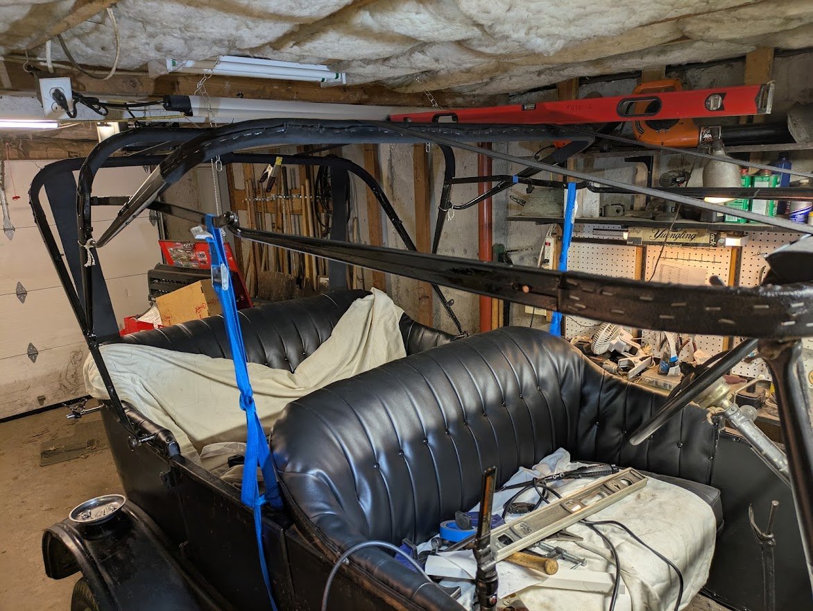

I think I FINALLY figured it out. Dan's photo of the Touring without the top made it a bunch clearer to me; and maybe to others. In looking closely, I saw that the front bow is horizontal/level with the top of the front door. That allows the #2 bow to drop down a little lower. My front bow was able to drop down; however, it wouldn't stay down. And as a result, the #2 bow was always level with #3 or higher.
How to fix (at least for now): I tied (blue) come-alongs to the rear doors and pulled down on the front bow until it was level, and locked off the come-along. This seemed to fix the situation. The #2 bow is now lower than the #3.

Show us a side view of your bows, please.

Side view of the bows. It's a tight spot for a picture . Camera is on wide angle.
John

Mark's photo shoes an exaggerated height to the second bow. Jeff's photo is more usual. The side of the top is straight back to the third bow, and only then curves down some at the back.
