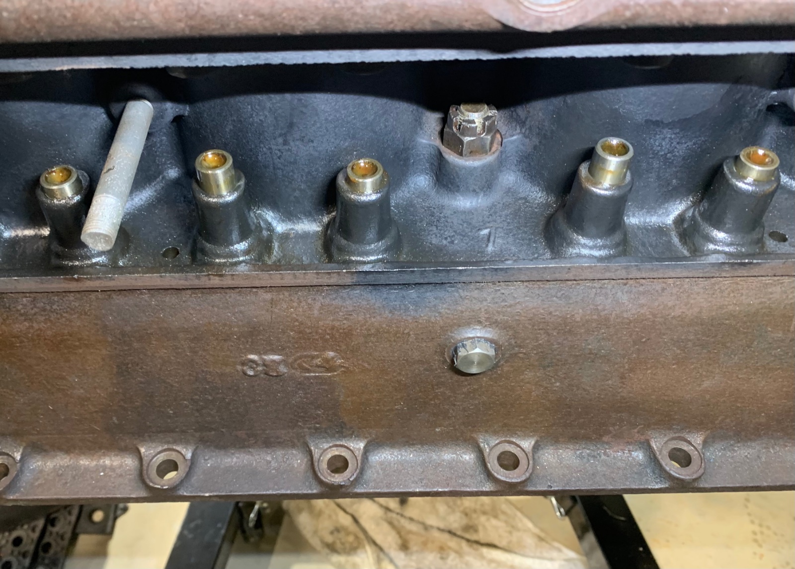

I recently bought a speedster project and it came with an assembled short block with a drilled “C” crank (counterweighted Model A crank) and insert rods. The closer that I look at it, the more questions that I have. I don’t necessarily want to change any of these parts, but I would like to know what I’m working with.
1) What rods are these? I believe that the rod bolts are modern TTY bolts and have already been torqued. So I believe that I’ll have to relegate these to “shop bolts” and get new ones for the final assembly. And as seen here, the bolt heads will need to be modified for clearance towards the side of the block. The rods do have the T style wrist pin pinch bolts.
2) What lifters are these? The lifters are cupped for modern pushrods (which I consider a good thing for the Roof 8 head that is going on this engine). But I mic’ed the exposed part of the lifters and they measure at .499-.500. Given that .030 over T tappets are .467 and these are in there now, this block is not ever going back to T lifters. They do appear to be made for pressure oil, but I don’t know of a way to reasonably pressurize a Model T valvetrain, nor do I think that it is needed.
3) What kind of camshaft is this? I know that you can’t tell the grind from here, but the flywheel end of the camshaft sticks out further than other T cams that I have seen. I know that one can install a Model A cam in a Model T block, is this what they look like when that is done?

All I can add is the lifters are ford Y block. 292, 312.
A view of the cam might help to identify if its model A.

Your cam is the correct stock length. It looks funny because someone used to short a bushing.
The bushing protrudes about 1/2" from the back of the block. The bushing should be notched on the front top side about 1/8"
So, you have no issue with the cam.

Yes, a T cam must be shortened slightly when modifying it for driving my pump setup. Not a big deal when adding the drive slot. Yes, you have a T cam there.
