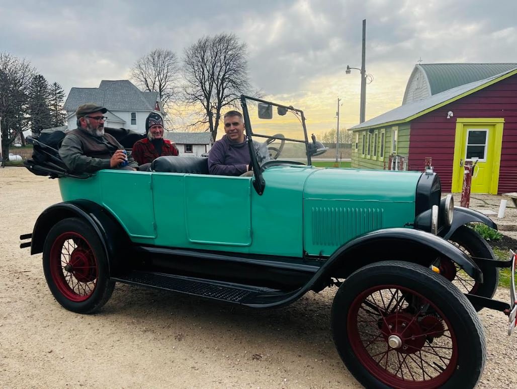

Hello. This spring, my brother and I went in together and purchased a Model T. A few years back, he came up with a bucket list idea that he would like to tour Yellowstone Park in an open touring car, and we've been working towards that goal since. Our old man was a high school teacher, and we spent every summer in the 80's and 90's up in Cooke City, just outside the Park. I practically learned to drive there.
We picked up a 1927 touring car last month. It's a real mixmaster, the story I got was that it was put together from parts many years ago - but it's a runner, and I was able to drive it 15 miles home the day I bought it. It has both Rocky Mountain brakes and a Ruckstell, which puts it close to what we need for a Yellowstone trip. Somewhere in the distant past, it was fitted out with a distributor setup (not a Bosch, not sure of what it is - it's stamped "Industria Argentina" inside). The is a Walker radiator intended for a small-block powered Hot Rod, but looks correct from the outside. It has a water pump installed, and it seems to hold between 160-180 so far. Also, the original Vaporizer carb setup was replaced with a Bendix sidedraft from a 2cyl Wisconsin industrial engine. Both are probably a travesty for collectors, but I figure the car has probably been operating like this longer than it was original, so the mods themselves are probably historical.
The carburetor bothered me, because it leaked and ran rich no matter what I did. I've replaced it with a EBay knockoff of a Ford 8N carb and made up a quick inlet tube to bolt to the vaporizer manifold. It runs strong and smooth, and will pull 45 on a flat with the throttle hardly opened. We do want to move to an original carb at some point, but for now I'm content.

She looks like a winner! a running car beats a 10 year "period correct" project in the garage.

I love the color. The flip side is that most folks are not crazy about it. My late wife bought a new leftover '67 Ford Fairlane in that color for a very reasonable price, because the dealer couldn't get rid of it due to the color' which I have always called "Swimming pool green". We had it for years - it was a great car. I'd probably still be driving it, but as is true of most cars of that era, in salt country it was a serious ruster.

I can honestly say that I own a mint Model T.
