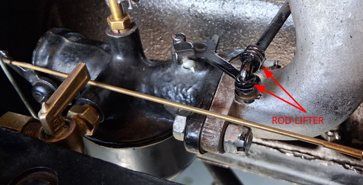

  • I verified the timer adjustment. I use a roller timer. Its lever is 65mm from center of the screw to its left, when spark-advance is fully up (latest ignition). When I pull the lever down 25mm and try to hand-crank, the engine already starts to kick back, while it does not with lever fully-up.. So I am pretty sure the adjustment is correct.

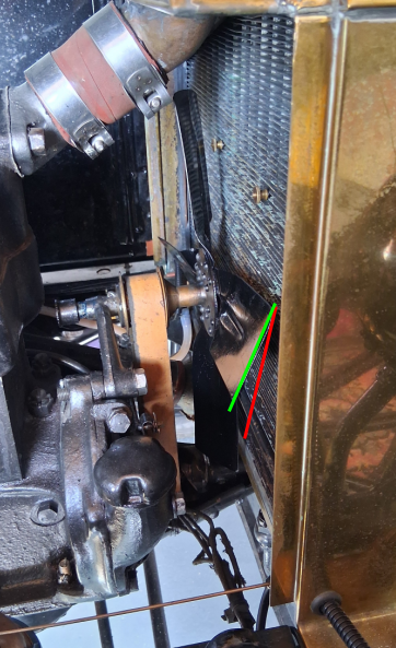

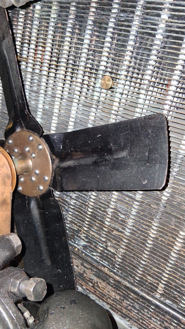

My T has a radiator fan which also is from that time. It is the one with a thin "neck" between its pulley and blades-hub (where blades are riveted on).
View on fan blades from a flat angle
If you wonder about this thumb nuts on radiator mesh... They hold a "Ford" Script on front of the radiator.

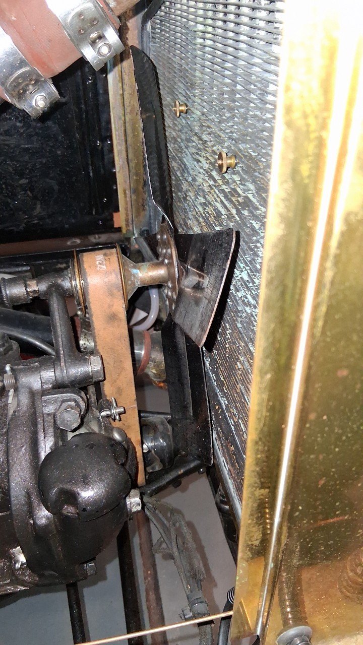

I also had to fix the fan by opening the hollow pulley from rear side and gluing in a turned brass insert using Epoxy. This is an invisible repair, allowing me to insert needle bearings. This was necessary because the former owner carelessly drilled up the center hole below the pulley and pressed in two needle bearings from rear, ignoring that the remaining wall became less than 0.5mm thin. So this wall broke off and there was no bearing below the pulley any more. The thin neck had to take all belt force and was also worn out heavily therefore. The new bearings work well and the fan is running smoothly again. They sit inside the pulley (all length of pulley) while the thin neck has no touch to the bolt any more.
View on fan from steeper angle
From my technical understanding the car has a problem with radiation. The radiator will for almost sure be ok, but it appears to have a little bit too low efficiency at higher environmental temperatures. I think a water pump will not help much. It possibly increases the circulation, but it will not increase the radiation itself. Also I dislike to add one because it reduces the originality. I think the best solution for increasing heat radiation is increasing the air flow through the radiator.
Please have a look on my pictures. This pictures are made before my change I did yesterday. Please have a close look on the fan, and the angle of fan blades.
For my opinion the fan blades are in a relatively flat angle, but I cannot compare with others, so I decided to ask here.
Yesterday I took out the fan and carefully bent the blades to a steeper angle close to the hub (on first 25mm). So when placing the fan with its front onto the workbench, the rear edge of the blades is now ~8mm higher. This way I increased the angle of fan blades some (approx 5) degrees, this should increase air flow.
I am very interested in your opinion and suggestions. It would be great if I could solve this problem once and forever. As this car was running almost everywhere in USA, also in lots hotter regions, I cannot believe that this problem cannot easily be solved.

I don't know about the geometry of the spark lever on your 1916, as compared my 1926, but I drive with the lever at 6 oclock. Try some more timing.

Is a separation of radiator fins visible? I had a close look (as far as possible, so actually to the second row of tubed from both sides), and it looks good. I could borrow an infrared camera from a friend and inspect the radiator with it. When thermal conduction somewhere exists, the fins should be lots cooler there.
I will give it a try and remove the "Ford" script in front of the radiator. I already mounted it in some distance using washers behind of it and the script is relatively narrow in most parts (mostly not more than 10-15mm wide) so air should easily get directly behind it, but you are right. It still is a barrier in air flow. And it seems this radiator is close to its limits.

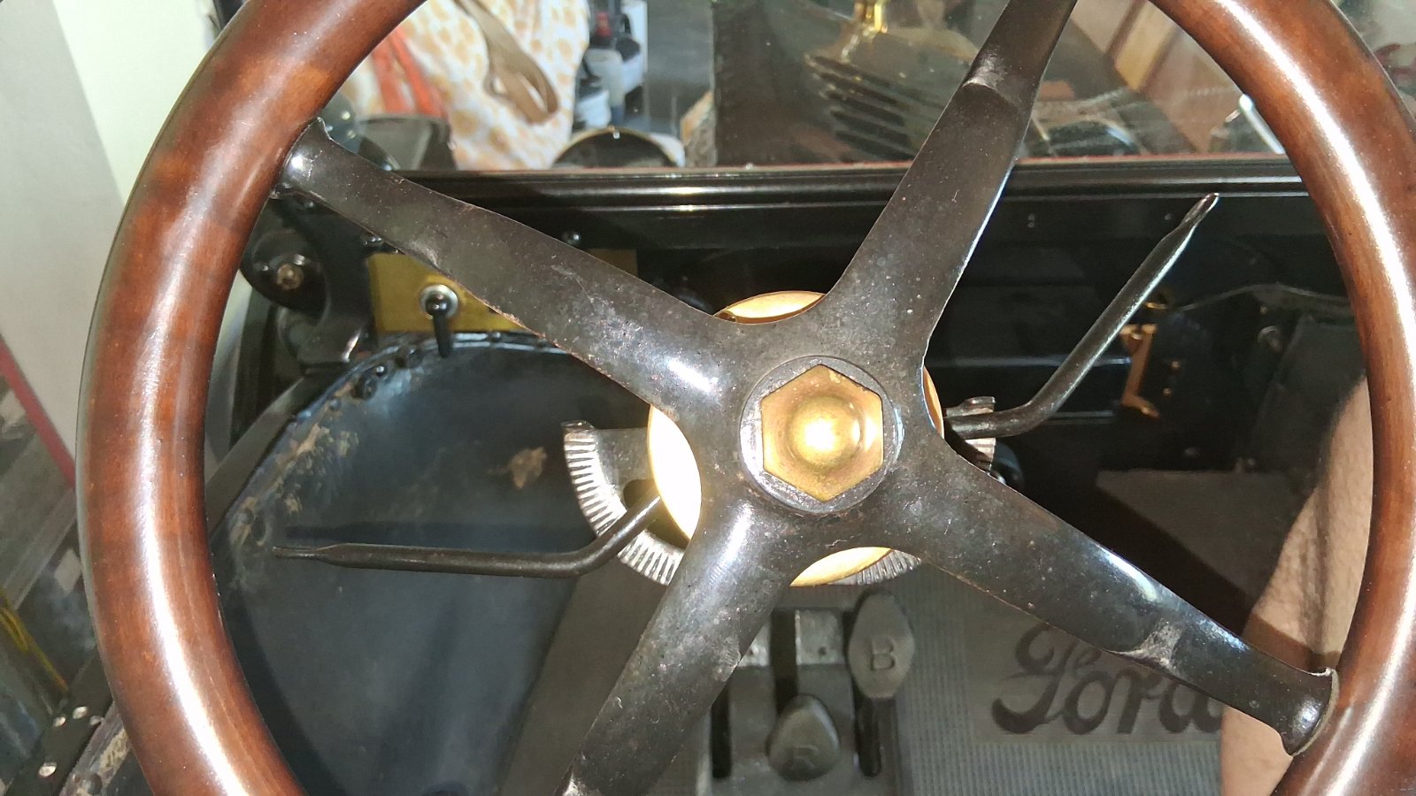

When engine is idling, I set the spark lever with long part horizontally. The short part is then pointing to approx at 8:00 position.
When driving at high, I usually set the advance to max, so the short part of the lever points to approx 6:00.
My T also runs cool when I am driving 15~18 MPH. Then the moto-meter settles a 1/4" below the hole.
This weekend I was driving approx 31 MPH at temperature between 85~100 F. Three persons inside, open top, little windspeed. The street had a very decent permanent inclination. The gas-lever was at approx 1/3 down. Here the moto-meter climbed to the upper margin of the hole. The engine started bucking every 4~5 seconds once. Then it made some fail ignitions.
I immediately reduced speed a bit and enriched the gas-mixture. Bucking and false ignitions immediately vanished and I drove the rest at 25 MPH.
Does this indicate something to you?

I noticed hat yours are missing.

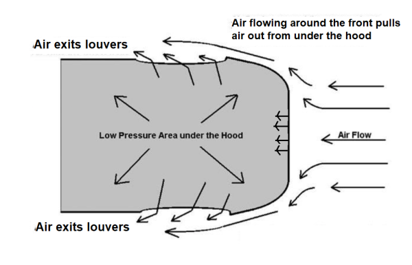

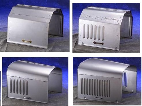

TRDxB2 wrote:
Mon Jun 09, 2025 7:20 pm
I am a advocate of having engine splash pans. Many don't reinstall them after doing some maintenance. I have observed that almost all issues with overheating have them removed. I am not saying that is the cause but they have an intended purpose. Cars in the 50's through the 80's didn't have the equivalent but all modern cars do. The negative pressure in the compartment draws more air through an out of the engine compartment.
To each his own like the water pump issue...but I am NOT. Experienced literally no difference with and without them. So when I used to buy a T that had them...off they went. Just too big of a PIA on many fronts. Except catching tools and parts that get dropped! :lol:

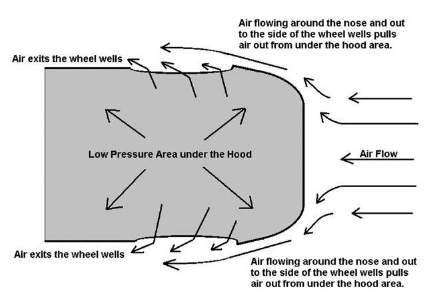

Allan wrote:
Tue Jun 10, 2025 9:04 pm
With so much stuff jammed under the hoods of modern cars,and with the speeds at which they travel, I can understand the need to consider/design them to have maximum cooling effect/airflow. If this became necessary in the 80's why wasn't it needed earlier. To suggest that it was a consideration way back in the early 1900's is a stretch too far. The use of engine pans on early cars, and the introduction of air cleaners, is more likely a reflection of the road conditions of the time. Mud and dust from unsealed roads were likely targets.
Agree that the pans were intended to minimize the dust, mud splash & water spray from the engine compartment. Buy what about the louvers on the hood side panels then? Why were they added and increased in numbers over time. In any case, regardless of the intention for having pans & hood louvers both back then, doesn't it make sense now to use them to assist in a better cooling air flow.

Well, I see this splash boards from a different perspective.
Yes, they are good for protecting the engine compartment from dirt and mud. That's it.
From airflow (cooling) side I do not agree very much. Yes, in theory they may enhance the air flow. But have a look on this sweet, little louvers. My 1916 has - IIRC - 5~6 of them on each side, and they are relatively small and close to the rear end of engine hood. Now compare their free cross-section with the free cross-section (= full area) of radiator. They are less than 10% of it!
From physical law, the air volume on intake and outlet side must be equal. So - regardless of number and size of louvers - they cannot take all the air needed to take away the generated heat.
Another fact is the relatively precise fit of the firewall. 5cm (2") around the Hogshead is not really much (but better than all louvers in total.
So I am inclined to not see the splash-boards as bearing a positive thermal solution. Even worse. If you have low air flow because of tailwind, hot air will be enclosed in the engine compartment lots more than without splash-boards (here some air can swirl in from bottom side and help lowering the temperature around the engine.
Yes, if they only cover the opening between cylinder 3 and radiator, you may gain a little more air flow (because then you have enough cross-section in rear for air-out), but at moderate speed, when driving a long slope, this will be relative... you are slower and run the engine on high power (low air flow + much heat).
I would say splash-boards will have not much effect in cooling, as others stated, too.

Ford placed a spark timing control and a carburetor main jet control at the driver's fingertips. Learn how to use them correctly, and use them, as needed and when needed.
J1MGOLDEN
Posts: 1323
Last Name: Golden
Location: Bowie, MD
Re: Engine runs too hot
Post by J1MGOLDEN » Wed Jun 11, 2025 2:00 pm
Those fan blades look dangerously close to the radiator fins.

About fan blade spacing to radiator fins... It only looks so. There is a gap of 1/2", this is more than sufficient. My fan is running precisely on needle bearings with almost no play. So no extra safety space needed. Though, the distance is also defined by the fan itself, the length of its thin neck.
You could have saved the time for writing this, TXGOAT2. Not really helpful. :roll:
What this levers and knobs are doing, I know. I asked for the most likely reason for running hot, to do then the right things. -- You see the little difference between "trial and error" and "doing it right"? ;)

Hello, TXGOAT2.
Yesterday I did some final tests. I had the plan to take out the carburetor and look into the bowl (if float is correctly adjusted and/or dirt is inside). Reading the User Manual where you pointed me to, I found a description of engine running hot, carburetor settings, ..., and that the engine is running better and cooler with lean mixture than with rich mixture. So I wanted to do some tests before taking out the carburetor.
Test of gas-flow into carburetor.
With open gas-valves, I opened the drain on carburetor. The continuous flow of gas coming out the engine never can swallow, so the entire gas-flow cannot be clogged somewhere.
Testing the mixture setting.
  • First I carefully closed the main-jet and made a marker onto the adjustment knob, then I turned it back to the former position. It was 1 1/2 turns from close.
  • I started the engine and let it idle to get warm for 10 minutes. See lever settings in below picture.
  • Now I wanted to find the lowest lean-setting, so I started to slowly close the main-jet. I expected to find a position where the engine starts to run bumpy within 1/2 ~ 3/4 turn. Surprisingly I was able to turn the needle in 1 1/4 turns until the engine started to idle a very little bit bumpy. After a very little further turn (~5 degrees?) it immediately stalled.
  • I opened the main-jet 10 degrees (a very little more than where the engine ran bumpy) and started the engine. It started easily and idled smoothly for many minutes (then I turned it off). It also accelerated fine when opening the throttle.

Finally I fixed minor problem with throttle-rod at carburetor end. This rod is bent in a 90° angle with inner radius of 2~3mm. So the actuator lever's hole was worn out because the rod always rubbed with its "round edge". I wrapped a bit of iron wire around the rod to keep it 2mm lifted, so the straight part is now inside the lever's hole. LOTS better than before and does not hurt (see picture below).
My "throttle-rod lifter".
As mentioned previously, I also increased the angle of radiator fan blades. Before I could not notice a noteworthy air-flow at center of Cylinder 1, now it is lots more, even on idling engine. Thanks for notifying me! Below you see the new angle, I marked the old angle in this picture, too.
Ventilator Anstellung.png (483.09 KiB) Viewed 9026 times
Green is new angle, red is previous angle.

The carburetor was fine (now verified by inspection) and was finally re-adjusted. Possible there was an almost invisible amount of dirt somewhere, but I don't think so. The air-flow through radiator (and then around the engine) is much better than before.
This combination most likely solved the temperature problem.
