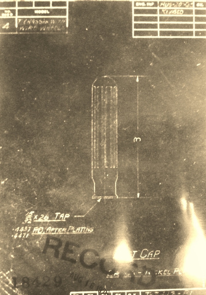

"It is also necessary to provide a longer dust cap for the valve stem, these parts being also obtainable through the various tire dealers."
Here is the print for that 3" dust cap, note in the upper left corner " Chassis with wire wheels"
So the std. 777 was used on the wire wheels, longer dust cap as the rim of the wire wheel is thinner than a felloe with demountable rim.

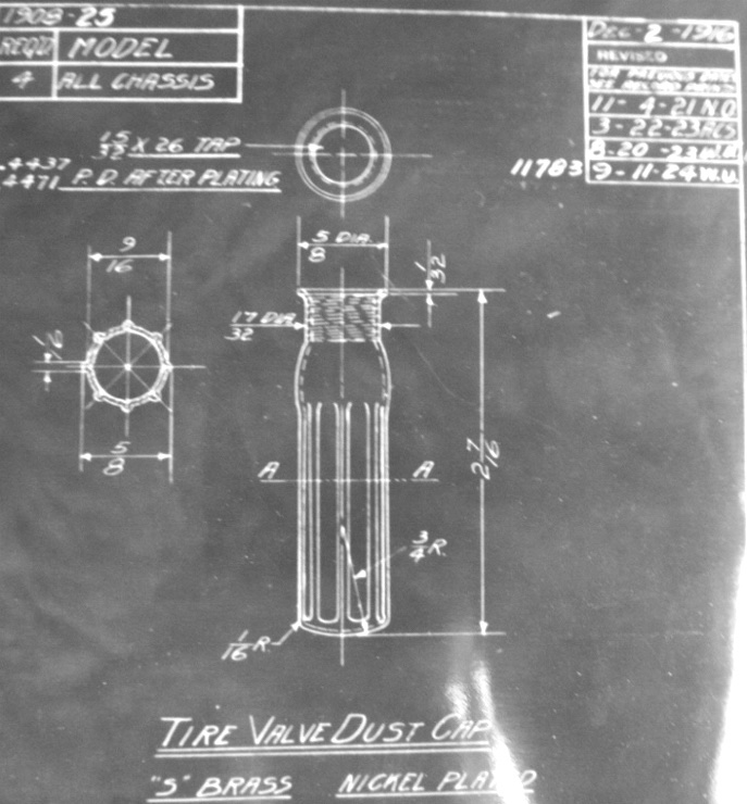

For ref. the std dust cap for the T ( without wire wheel) and using the 777 stem is 2 7/16"
