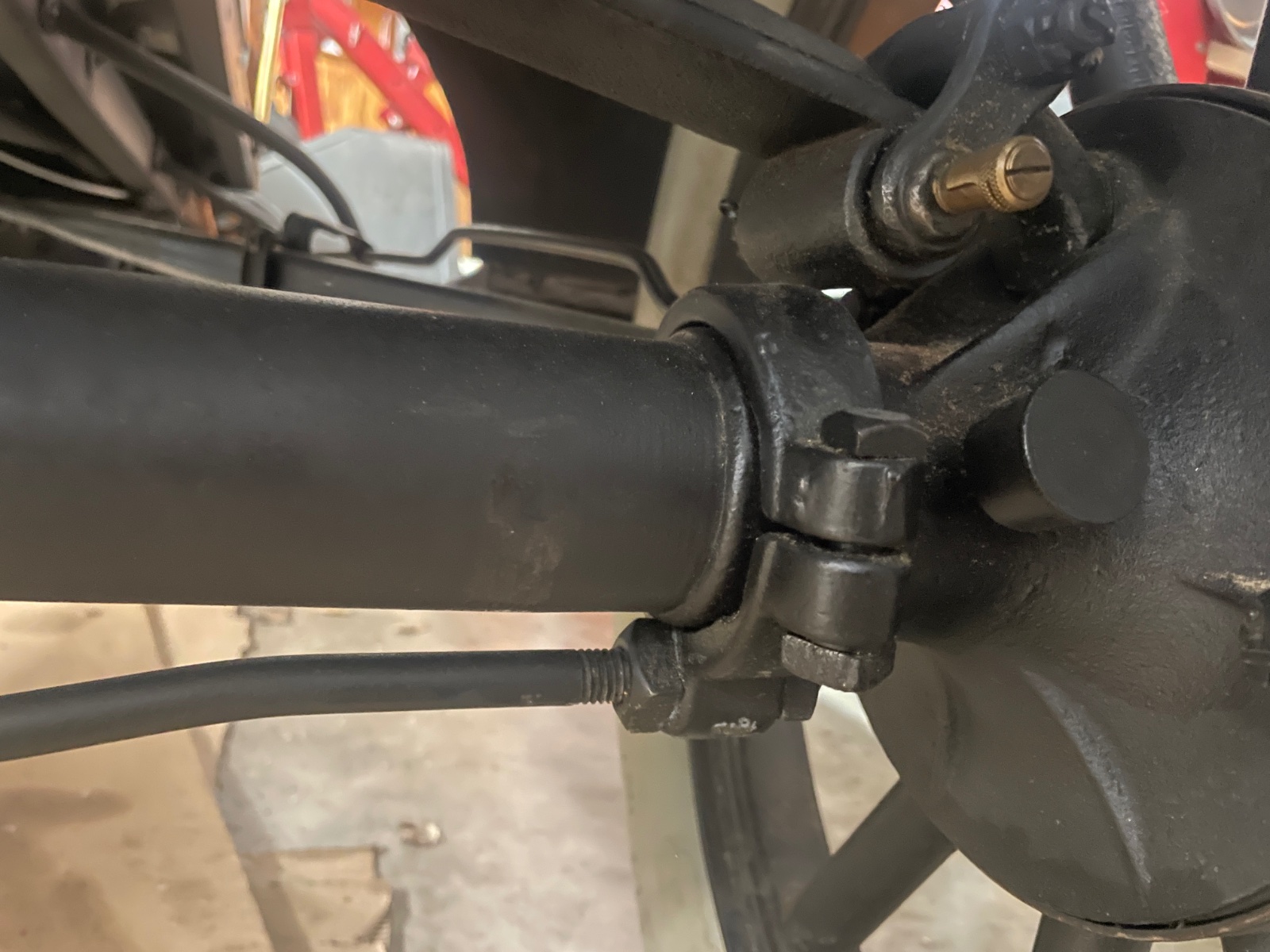

Has the cast brackets that clamp around the axle housing, you have to drill mounting bolt holes and of course add your own cross bar. A length of steel rod is all that is needed.
1046-500 Truss clamping brackets not drilled (set of 2)
$66.00[
/b]
Put a set on my '12 project open express.
Clamp bracket.jpeg (63.06 KiB) Viewed 1165 times

DanTreace wrote:
Fri Jun 27, 2025 9:35 pm
ModelTRanch.com
$66.00[
/b]

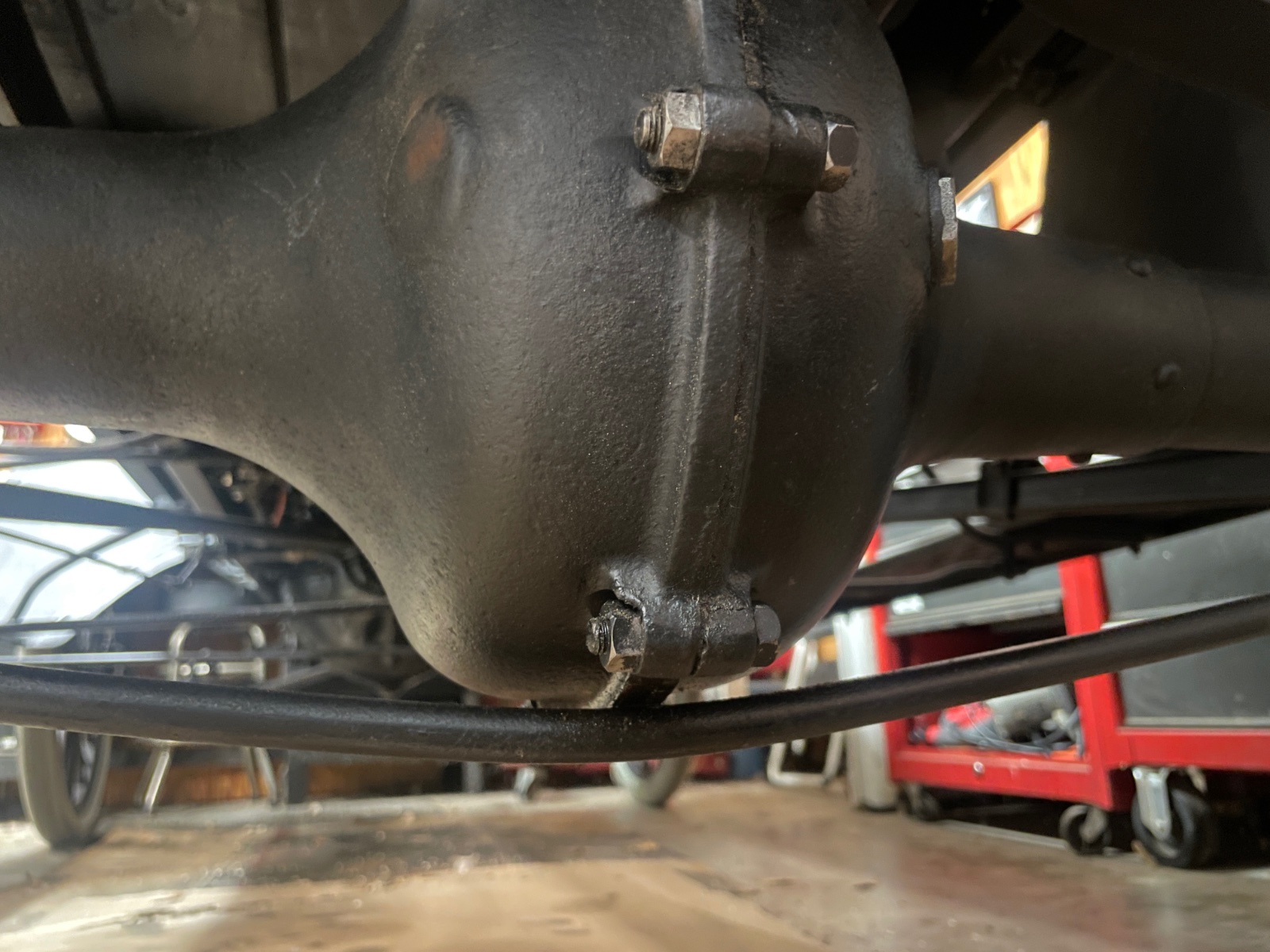

What keeps the rod in place when it goes under the pumpkin?

Mine has a cast bracket that nestles one of the lower pumpkin bolts.

On my '12 open express project, just did the shade tree fix, bent the steel rod to run close under the pumpkin. At least looks good to me! Besides the heavy cast later pumpkin is plenty strong.
And some types of the rear axle braces were made with just a support rod, not fixed to the pumpkin.
IMG_0002 (550x372).jpg (96.47 KiB) Viewed 994 times
Did a lucky find one time at Hershey Swap years ago, a complete original accessory axle brace, with the plate that fits to one side of the pumpkin, and had square lock nuts to fix the long rod that was threaded also in the middle. Paid a bunch more $$ for that original set up, as the seller knew what it was and how rare. My later add on garage made unit was so less $ :lol:

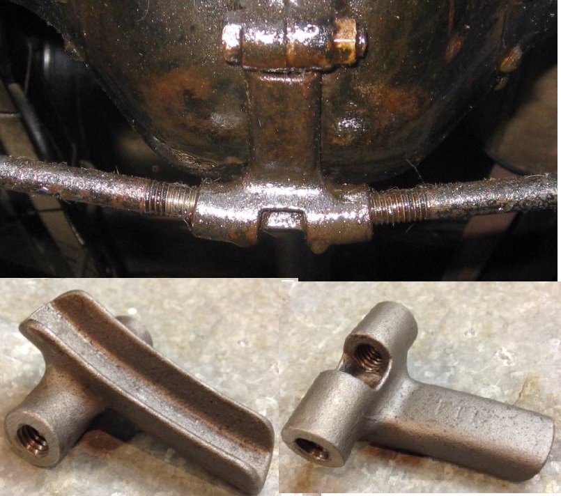

Shows pictures og different styles & the original attachment that goes on the pumpkin https://www.mtfca.com/discus/messages/1 ... 29976.html
This is a DIY setup for all part but the pumpkin part is of interest https://www.mtfca.com/discus/messages/4 ... 75167.html
These pictures are from another links
