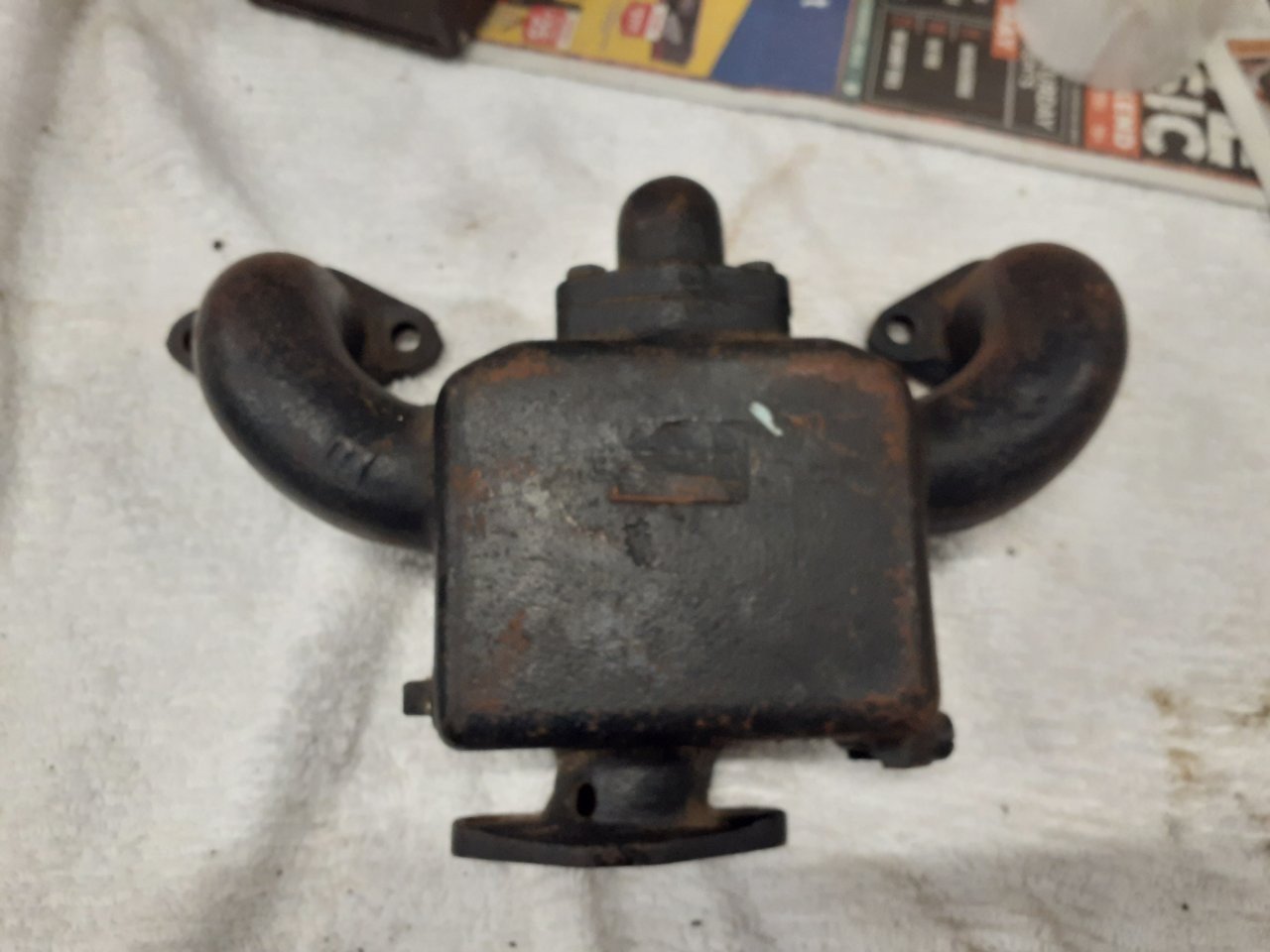

For you Rajo guys, saw this on Tbay would this really fit a T?

I have no connection to the part or seller but was curious about the number of intake ports & wondered how this would adapt to a T. Did Rajo have a 3 port head assembly for a T? Best John

The center port is open to exhaust gasses to pre-heat the manifold

Are you certain it's exhaust gasses and not coolant? The pipe thread port at the bottom makes me wonder if it's a coolant return port.

I run a BB - it's an exhaust port !

Okay ! Thanks !
