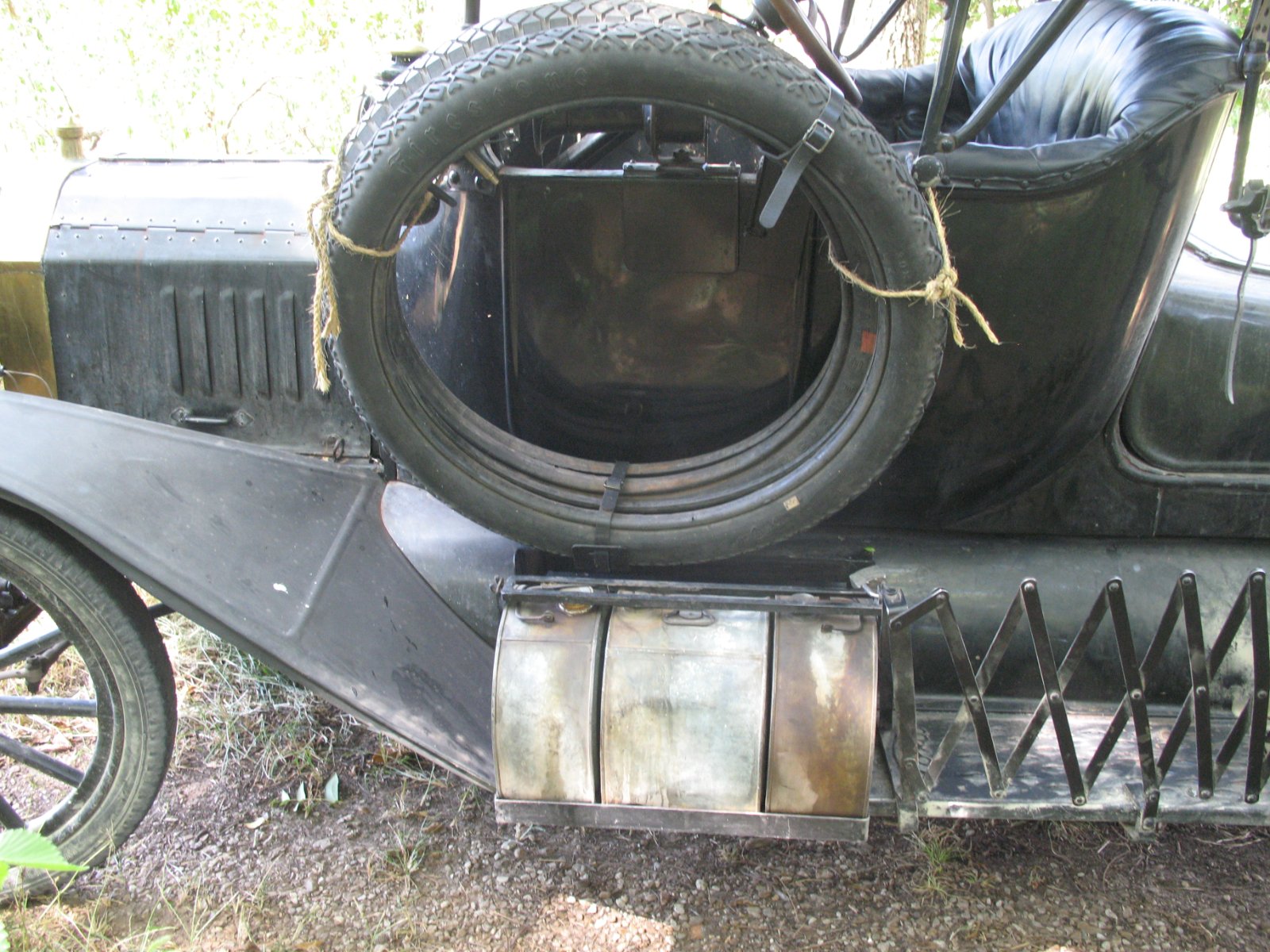

I do have a set of running board cans, but all of the gas falls out of the bottom of the red one before I get a chance to even lock them in the rack. :?

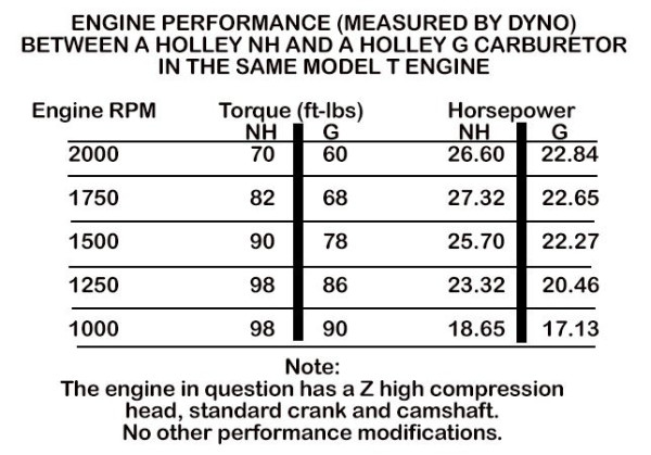

While I loved the Holley G that came with my '17 I learned it had some drawbacks. When compared to a NH, the NH actually produces more power. Add to that the Scott Conger Full-flow valve and most of the problems you described are eliminated. FWIW, we did a side by side dyno test of a Holley G and a NH on the same engine with the attached results. I've installed a NH and been very happy with it. Also, you might want to know that fuel consumption with the G and the NH with the full-flow valve is unchanged. I just don't get any sputtering when the tank gets low.
