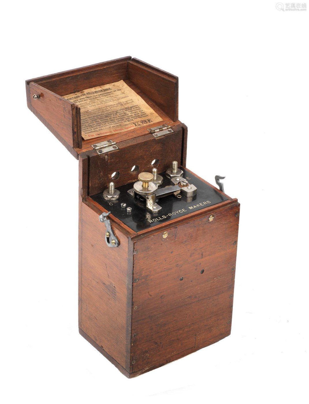

I was a buzz box guy. Even built and sold a few on E Bay. This was years ago and I was taught a lesson when a friend who lives not far from me contacted me through the Forum. He had an HCCT and did coils for the local club. I had rebuilt mine, ( cap, points etc ) and he came over and set them up for me. My car started, dead cold, on the hand crank after we reinstalled them. Brother I was sold.
Posts: 8378
Re: question on how to adjust/test coils
Post by TXGOAT2 » Sat Jul 12, 2025 8:33 am
A buzz box is much better than trying to adjust coils "by ear". But an HCCT is FAR BETTER, and an ECCT is best.
