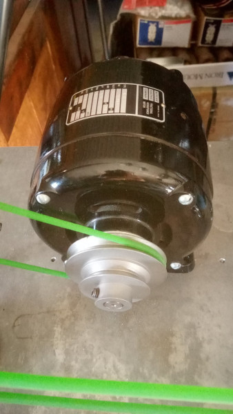

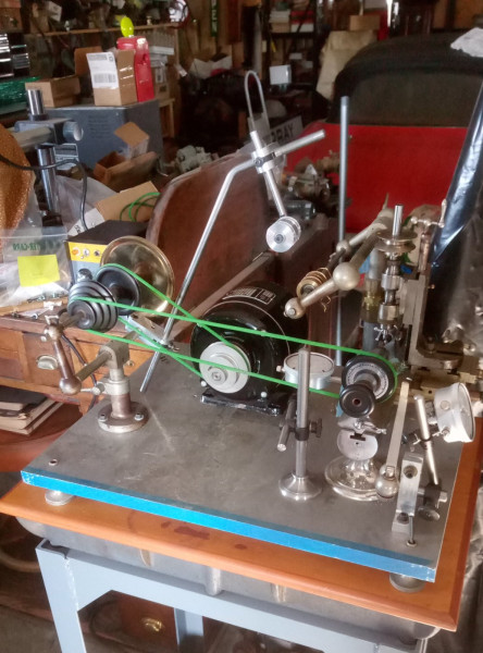

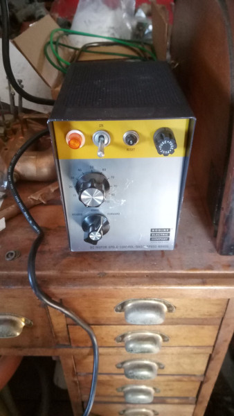

I recently completed the purchase of a new, more powerful motor for my jet manufacturing lathe. Previously, it was powered by a typical high-speed, low power motor. At 1/15 HP it relied on very high speeds and tiny pully to generate the necessary torque to run various accessories.
Bodine motors and controllers are probably the Duesenberg of motors and after finding a NOS 1/8 HP motor two years ago, I finally found the mating controller in excellent shape. Since it is cast iron, including the base, his motor is the same size/weight of a motor twice its HP rating and though is relatively low in HP, it has huge torque throughout its entire speed range, which is what I need. This combination sells new for around $850 but with patience was assembled via eBay for right at $200.
It is now hooked up and is a beast - I could not be more pleased. If you are a watchmaker or clockmaker or have any kind of instrument lathe, you will do yourself a favor if you spend the time to invest in such a setup.
Since Levin Lathe company uses Bodine motors and controllers (and I have had the good fortune to use them), it was something I'd wanted for quite a long time

Scott,
Great setup - Nice Lathe.
However,
It does look a bit "Rube Goldberg" :D :lol: :shock:

Posting this to give someone an idea for fixturing things...
Teflon tape (.022 thk with PSA)
Inexpensive fixture track typically used by woodworkers, inlaid flush on a bench or other surface (Rockler)
Double-stick tape (3M)
I needed to be able to move this heavy motor back and forth behind the lathe to accept any number of locations supporting multiple possible attachments and yet still be able to sock it down tightly to keep tension on belt(s). I used the fixture track rather than mill out the aluminum baseplate, then applied Teflon tape to the feet of the HEAVY motor. Finally, before committing the track to a permanent position, the two tracks were laid in place using double sticky tape.
The whole thing is rock solid when tightened down and when loosened, the motor glides over the track almost effortlessly as if on ice. Simply snug down the nuts on the T Bolts and everything is socked down again. I may not even screw the track down, it's that positive of a locator...we'll see...
Anyone who has done much machining, knows about fixturing and I thought I'd share an unexpectedly resounding success with others with the hope to inspire the use of some non-traditional methods or materials.
