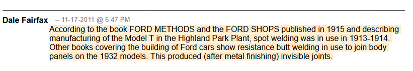

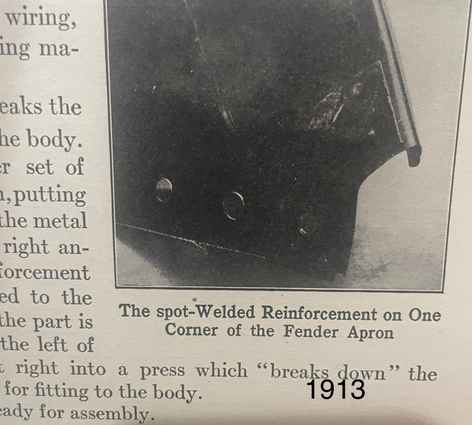

Yes. Ford was electric spot welding since at least 1913.
Mostly fenders then, but when body builds were in house, lots of spot welds were used.
Ford Methods and the Ford Shops
The Ford Industries booklet

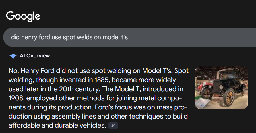

But you're gonna luv what A.I. has to say:

"AI" equals automated incompetence or automated idiocy. Google was always questionable in its quick answers, however, in the past year they have become laughably unreliable.

The A I cloud geniuses are about as bright as the T photos that get posted from time to time elsewhere on other sites. The photos of the classic car era cars are a lot worse than the T era if that’s possible. Isn’t progress interesting!

The AI output in search engines is nothing more than a machine generated summary of the target subject collected from various data sources across the web. Despite the name, or presumption, there is no intelligence, there is no proofing, it merely is garbage in garbage out...it just does it faster.
The old adage of not believing everything you read on the web still holds true, regardless of anyone trying to convince you the "I" in AI is actually operative....

Google AI works by using machine learning algorithms and vast amounts of data to analyze patterns, make predictions, and generate content.
Putting that in common English: It searchs the internet and compiles the most common answers to the question presented and formulates the answer in one or more English sentences. It isn't really a new thing. "Alexa" (Google), "Siri" (iPhone) are earlier AI forms.
Much depends on how the question is presented So Henry Ford did not spot weld his employees did
