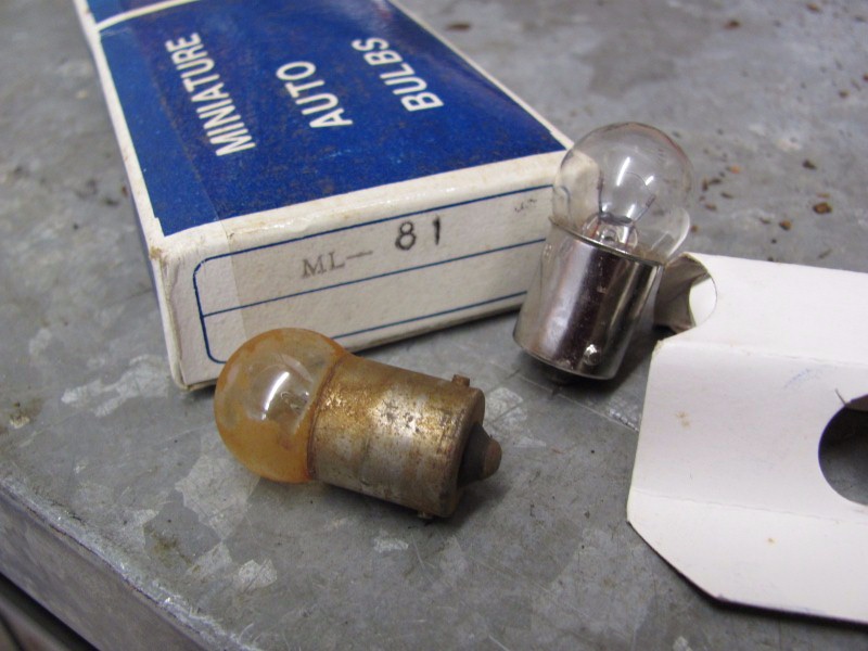

For 6v. use the std. #63 bulb, 3 c.p., 0.6 amps. found in most auto stores. A bit brighter, with same bulb globe size is a 6v. #81, 6 c.p., 1.05 amps., but harder to find.
These #63, #81 and #87 now are also known with the newer description 'BA15s' lamps, meaning bayonet base, single contact, std pins. (not offset pins)
As for 12v, don't know that number, but a counter parts guy will find you a match BA15s.
I bought a supply of the old time brighter 6v. #81 from the buggy shop, Witmer Coach, New Holland PA. Fun catalog of horse buggy parts, but carries hardware stuff and at least a few years ago full selection of old time automotive bulbs. Also have gotten from them 6v. #87, 15 c.p., 1.91 amps.good for spot or ditch lamps mounted on your windshield post.

For the small globe bulb, the 6v. #87 is what I use for stop lamps at the underside of the wood bed on the '23 cutdown. Use similar housing with red glass lens as those Do-Ray. Pretty bright 12watt, 15 c.p.
As most flashers use the brake lights, the #87 should be ok.
Twin brake lamps using Do-Ray style old metal clearance lamp housings, with red glass lens. The small #87 fit good, the globe size didn't hit the inside of the cone lens.
Fairly bright for 6v 15cp.
