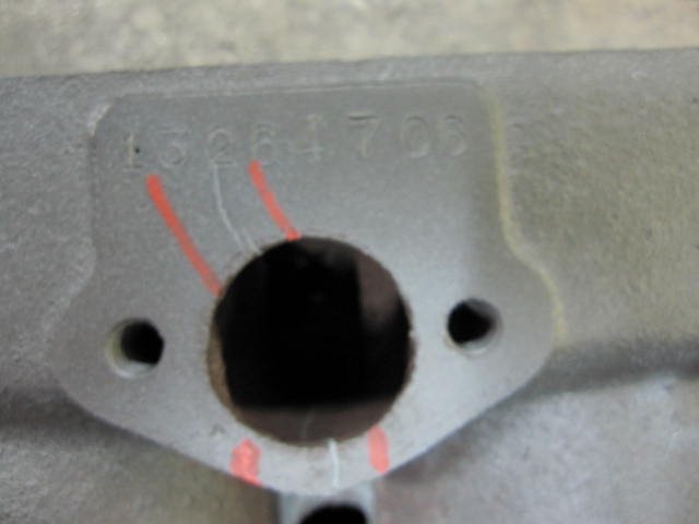

There is a dry version where user has a electrified tool/magnet with a north and south pole that when placed on flat one dimensional parts, the user dusts iron powder over area to be checked, if part is cracked the powder which is magnetic will get drawn into the void highlighting crack. as seen in picture of water outlet cracked to serial number.

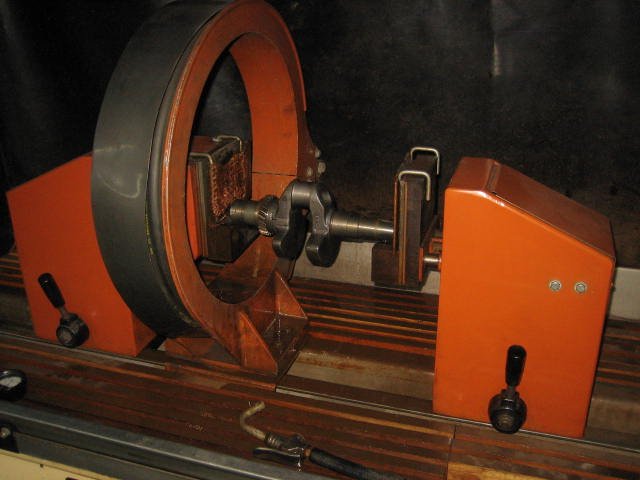

There is also a wet mag machine used for 3 dimensional objects such as crankshafts and cylinder heads, axles, etc.
The part to be checked is placed in the machine between copper pads to recreate North and south of a magnet, thereby when the part is charged through the machine causing part to become magnetized. Then there is a hoop that is passed over each of the rod and main journals to charge around the circumference of the part in question. See second photo.
The part is doused with a non-flammable liquid solution that has luminescent magnetic powder in it.
When the part becomes doused with the solution, the magnetism of the part will attract the iron particles of the solution to the crack.
If there are cracks they will immediately be highlighted by using the black light .
If you'll notice, picture of the crankshaft being highlighted with a fine green line ,as this is the crack in the crankshaft.
