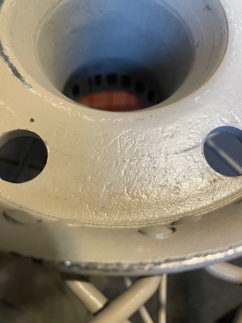

Are there any identifying markings inside the wheel centers…? You won’t find a brand name, but often there is a serial number and sometimes a small logo. Might be similarities with other known wheels. How bout some pics…?

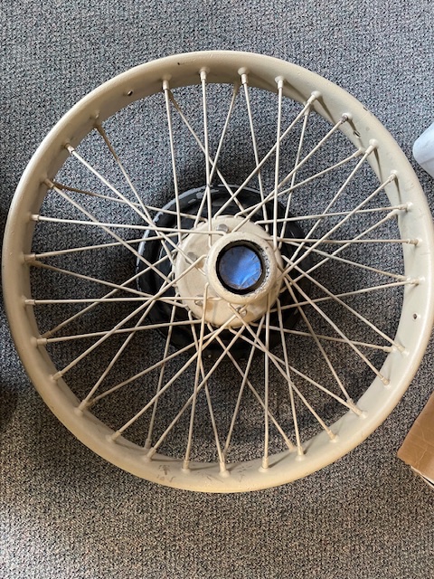

I looked at the wheels. One has what appears to be a poorly stamped “11” another has a poorly stamped “12” within a diamond (see pictures). I have also thrown in a shot of one of the wheels and the inside of a wheel hub.
