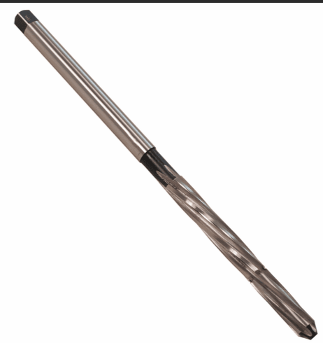

As others have stated, you need a guide to keep everything in line. You also should have a valve guide reamer, (i.e. not just any reamer). They look like this. Notice the leading 1/3 of the reamer has a built-in pilot/guide.

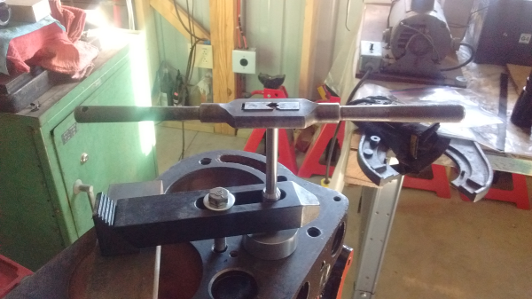

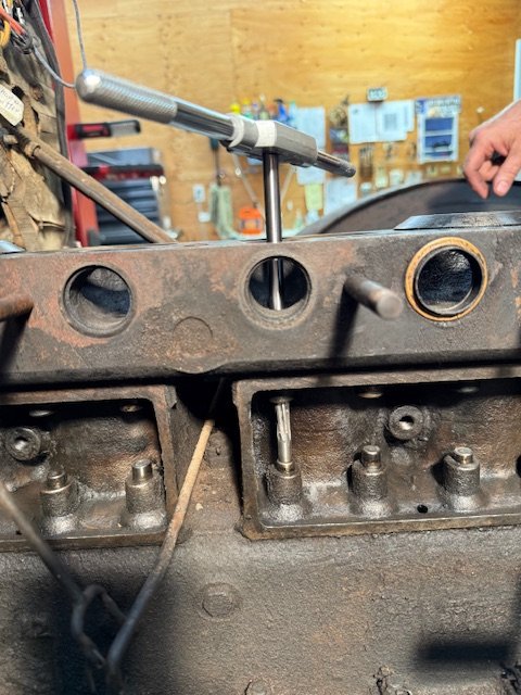

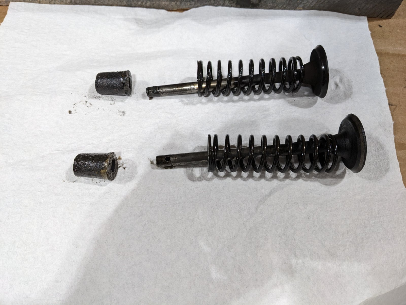

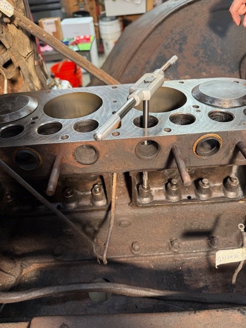

Attached are a couple of pictures showing my 1919 engine getting reamed. The standard .312 valves wobbled around in the guides. The engine machine shop owner who was helping me said the wobble was too much. So I decided to install .327 valves, which required reaming. I asked the machine shop owner do it. In the picture you will see that the bottom of the reamer does not have grooves on it. It follows the existing valve guide, as per the description on Snyder's website. I measured the width of the bottom "plain" end of the reamer and it was made to fit .312. After reaming the first guide he slipped a valve in then pulled it out and a smile crossed his face when it made a nice "POP" sound.

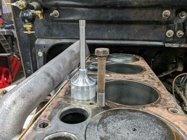

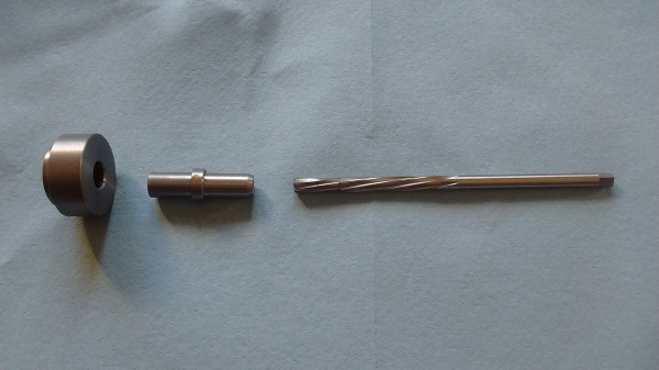

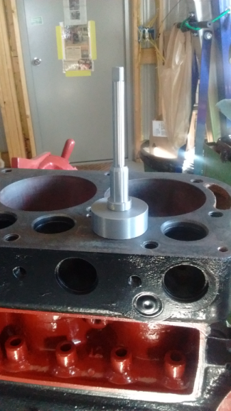

either through lack of experience or plain ineptitude, I have never been able to get a reamer to jam with this tool - though it will center the new hole all but perfectly to the valve seat regardless of how worn the original valve guide hole is, and final seat concentricity/clean-up with a Neway cutter is a snap:

In response to two questions, I purchased my .327 valves and the reamer shown in the 2 pictures from Snyder's.
