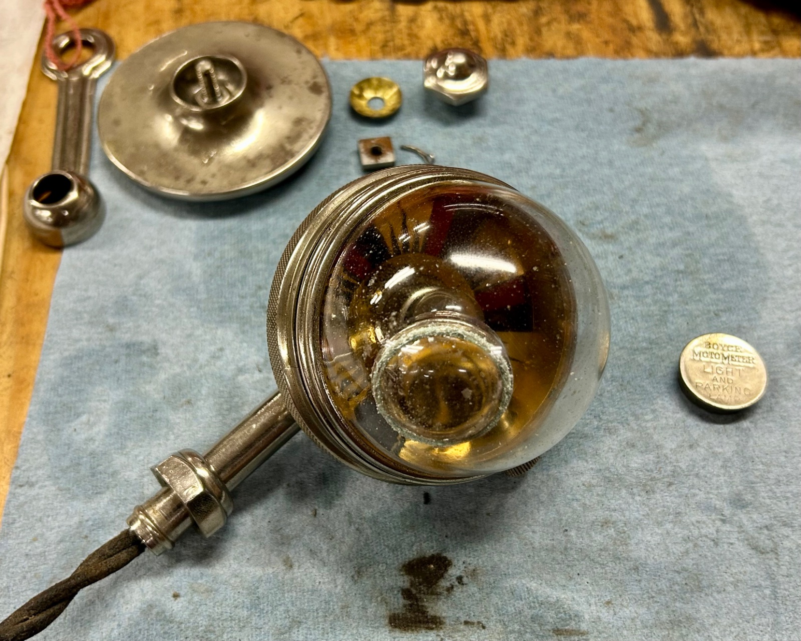

Has anyone ever had one of these apart to change the bulb?

?Thinking that the dome's bezel would unscrew from the base?

Thank you for the link Mr. Brandi. This unit is NOS out of its box, I’ve disassembled it this far but can’t figure out how to remove the glass lens. It almost seems pressed, I can’t imagine such an expensive product being sold without a means of replacing the bulb inside?

I even looked through Boyce patents and couldn’t find it, although everywhere on the light it says “Pat Pend”

Wonder if its set-up like a model T headlamp. spring under the reflector and studs to clear notchesTadpole wrote: ↑Mon Sep 22, 2025 8:43 pmThank you for the link Mr. Brandi. This unit is NOS out of its box, I’ve disassembled it this far but can’t figure out how to remove the glass lens. It almost seems pressed, I can’t imagine such an expensive product being sold without a means of replacing the bulb inside?
Push down on the bezel & rotate counter-clockwise ?
