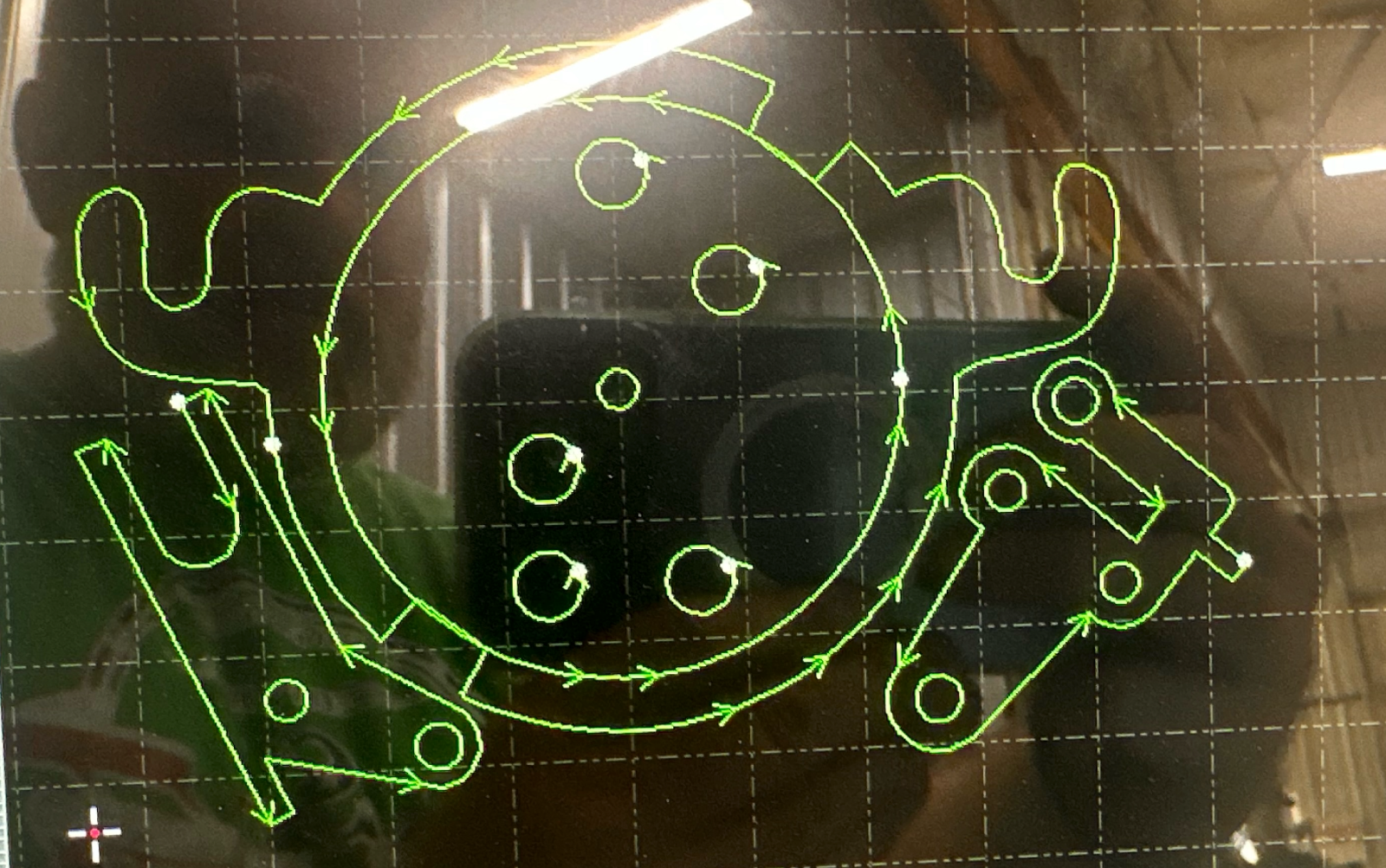

Progress update:
The Laser metal cutter is FIXED! I had to order replacements for several burned out parts in the servo control board, but this old man has't lost his touch when it comes to fixing power supplies...
Cutting parts today and tomorrow.
I've found about 37 cutout tops so far, but I need a LOT MORE!

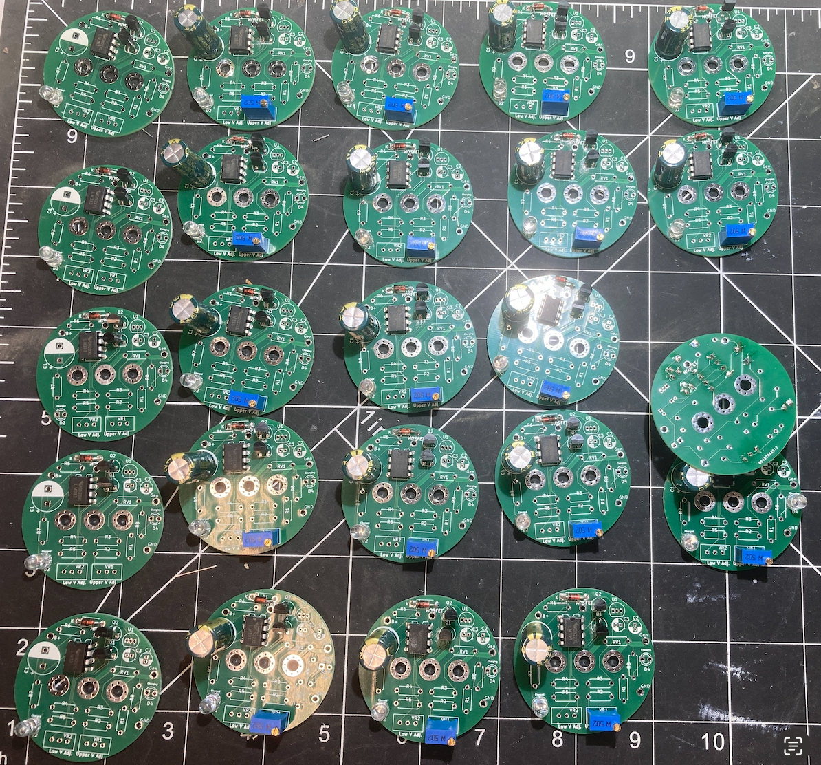

Curious... As someone who has zero experience in this area, how does one go about making, or having made, circuit boards such as those? Do you design the board, then have a company produce the boards for you? Do you solder each component to the board yourself, or does it come supplied that way?
All of the above. You start with a schematic, turn that into a circuit board, get them produced offshore and in this case I populate the boards. At some point I'll be converting to SMD (SURFACE MOUNT) and then have the fab house produce them.
The REALLY exciting news is I just got back from the laser cutting guy and pressed my first set of bases. They literally came out perfect. The old Ford Cutout cans fit perfectly. This is a VERY challenging part to reproduce. The angles are complex, and everything has to line up just right. I must have made a dozen changes to the deep draw die set I made.
Tomorrow I'll be cutting a few hundred copies. There really is light at the end of the tunnel, and it's a looong tunnel!

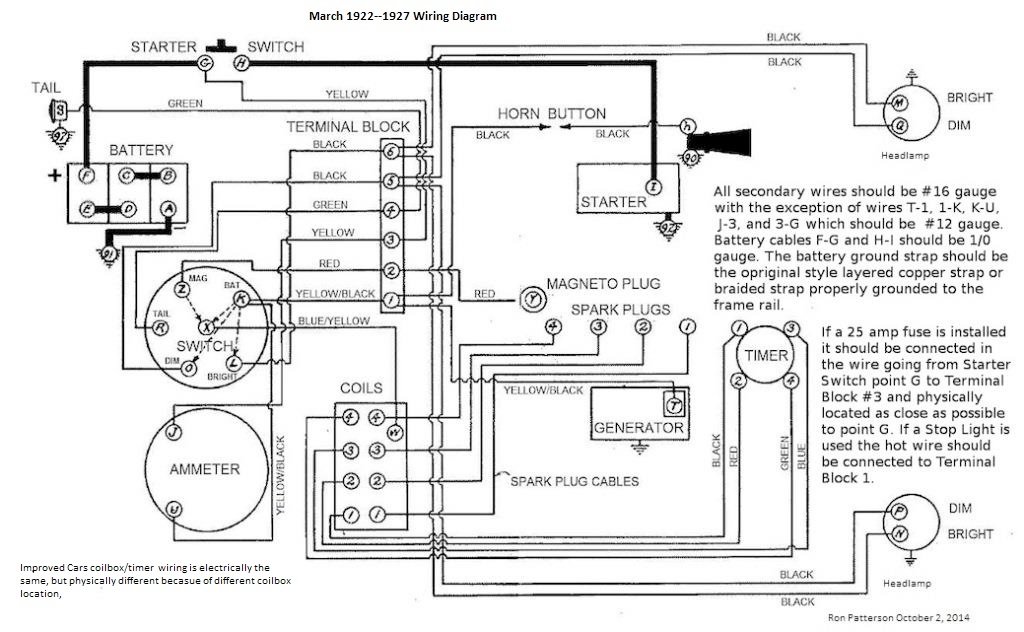

Have been trying to get ahold of Jeff on this.... (left a few messages). Maybe he is out of the office this week?
I purchased a 12v voltage regulator... it looks really nice!
I got it mounted properly, but I can't seem to locate a wiring diagram to know exactly where the inline fuse is supposed to be installed? It does mention a couple locations.
The brochure shows it with a blue wire, but I not really wanting to risk the installation incase his photo isn't using the same blue wire I have.
It is odd there are not any installation instructions on their website either.
Anyone have some photos or diagrams of where the fuse is supposed to be installed at?
I'd rather not blue smoke anything from assuming.

AdminJeff
Posts: 1114
Joined: Wed Jan 16, 2019 6:32 pm
First Name: Jeff
Last Name: Stevenson
* REQUIRED* Type and Year of Model Ts owned: 1921 Touring
Location: Wilder Idaho
Re: Voltage Regulator Building Progress Update
Post by AdminJeff » Tue Sep 23, 2025 5:39 pm
Ben, I'm sorry... on infinite hold with Fedex.
you insert the fuse wherever your car takes is main power from. on some cars its the starter foot switch (thats how it was originally wired).
On others it comes from the positive terminal of the battery.

fireheadman
Posts: 109
Joined: Fri Aug 08, 2025 1:26 pm
First Name: Ben
Last Name: Piraro
* REQUIRED* Type and Year of Model Ts owned: 1911 Model-T Pie Wagon
Location: Castle Rock, CO
Post by fireheadman » Tue Sep 23, 2025 9:00 pm
Thank you on the reply
Has there been any issues with the wire provided being too small to sit between the starter switch? My starter wire is pretty thick gauge. I suppose I could upgrade the inline fuse to something used in car amplifiers.
So just to clarify, we are supposed to cut the wire coming from the starter switch to the starter and place the inline fuse there?
