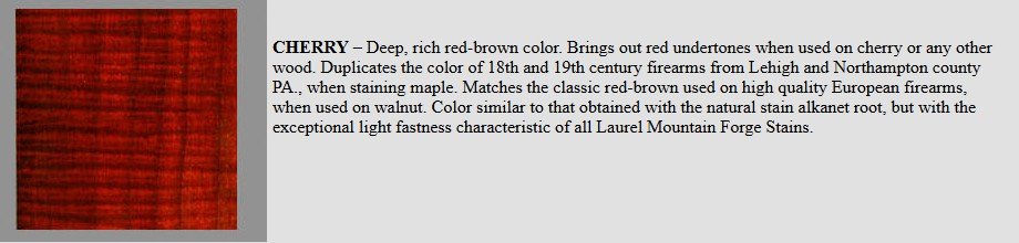

I am restoring a 1914 T that will be getting a new firewall. When I restored our 1911 Touring, I used Laurel Mountain Forge antique cherry stain, based on recommendations on the forum site. It really is a good match for the original stain Ford used, when comparing it to the portions of the firewall that had been hidden for over 100 years.
This weekend I looked to buy another bottle of LMF cherry stain, but the few online places that carried the stain show that it is out of stock. I have sent a message to LMF to see if or when it is still available, but in case it is not, does anyone have another stain recommendation? As can be seen in the picture pasted below, the stain is quite red, as the firewall is in the areas that had been hidden from view.
