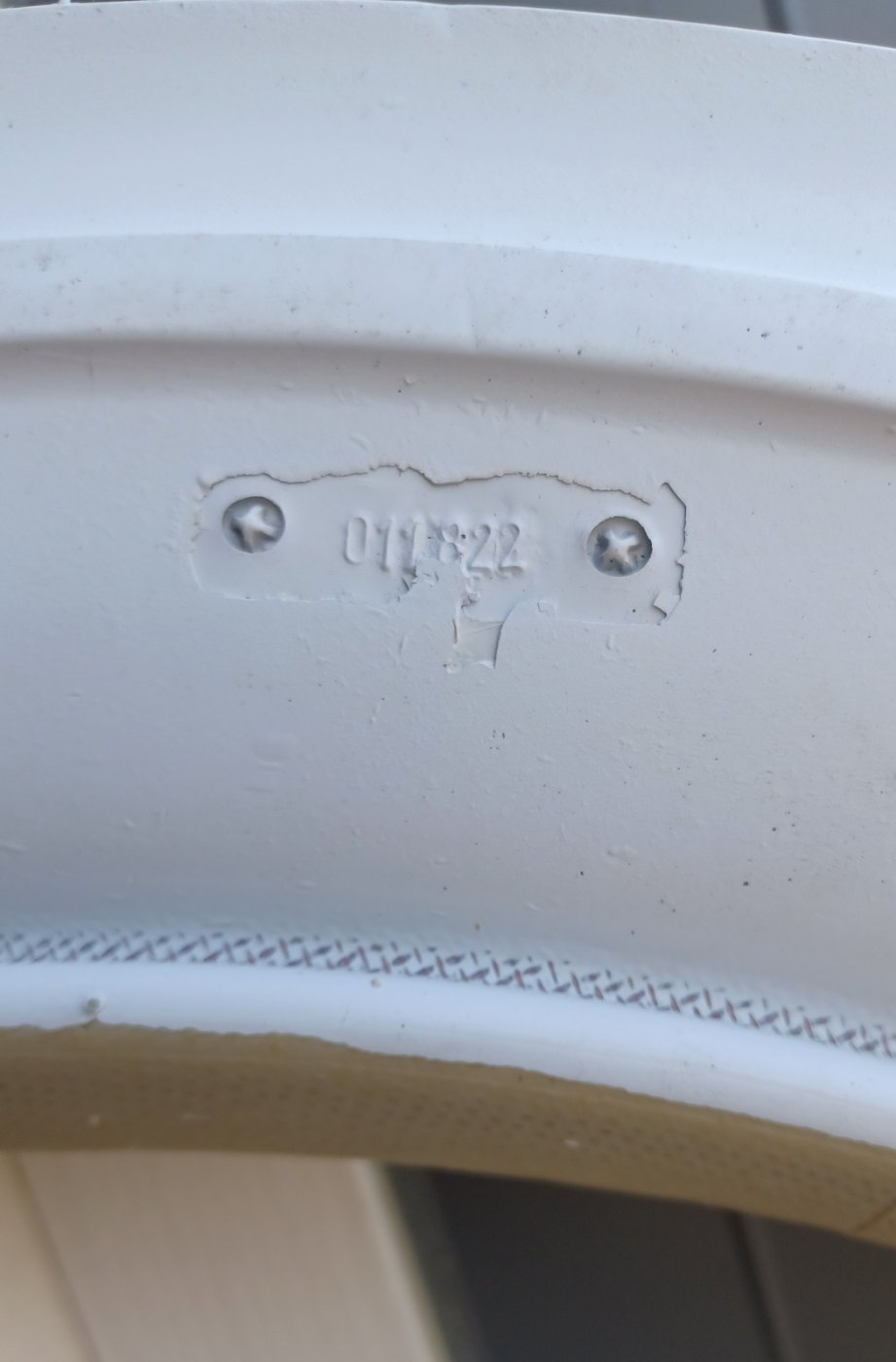

Inner tube schminnertube about them turning white tires brown or yellow. Never gonna believe that. How is a rubber tube gonna bleed through several layers of cord to the outside? Poppycock. Look at these pics of two different tires that were two different run dates. Try to convince me that the "white" isn't "topical"...painted on! It boils down to QUALITY and UV resistance!

You can spoil a set of new whitewall tires by storing them with the black side of one tire in contact with the white side of another. But you do as you like.

Early tires were made with natural rubber and no carbon black. It was found that adding carbon black to the rubber made the rubber far more durable. It also made it black. Ever since the WWII era, most all tires are made of synthetic rubber, or a blend of natural and synthetic rubber. Synthetic rubber is a petrochemical substance that emits gases, especially when it is new. The gases are capable of staining white wall tires. I do not know if modern white wall tires are made with white natural rubber or synthetic white rubber. Most all post-WWII white wall tires have a layer of white rubber in the carcass. It is not painted on. Antique all-white tires may be made differently today than they were in the early 20th century.
