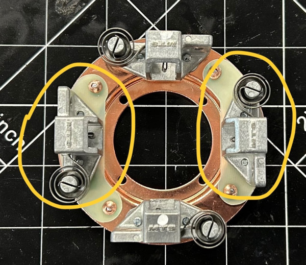

The starting motor field winding pig tails are connected to the adjacent insulated brush plate brush holders.

What Ron said. Here's a visual. Notice the insulators on the circled brush holders. the other 2 are grounded.
