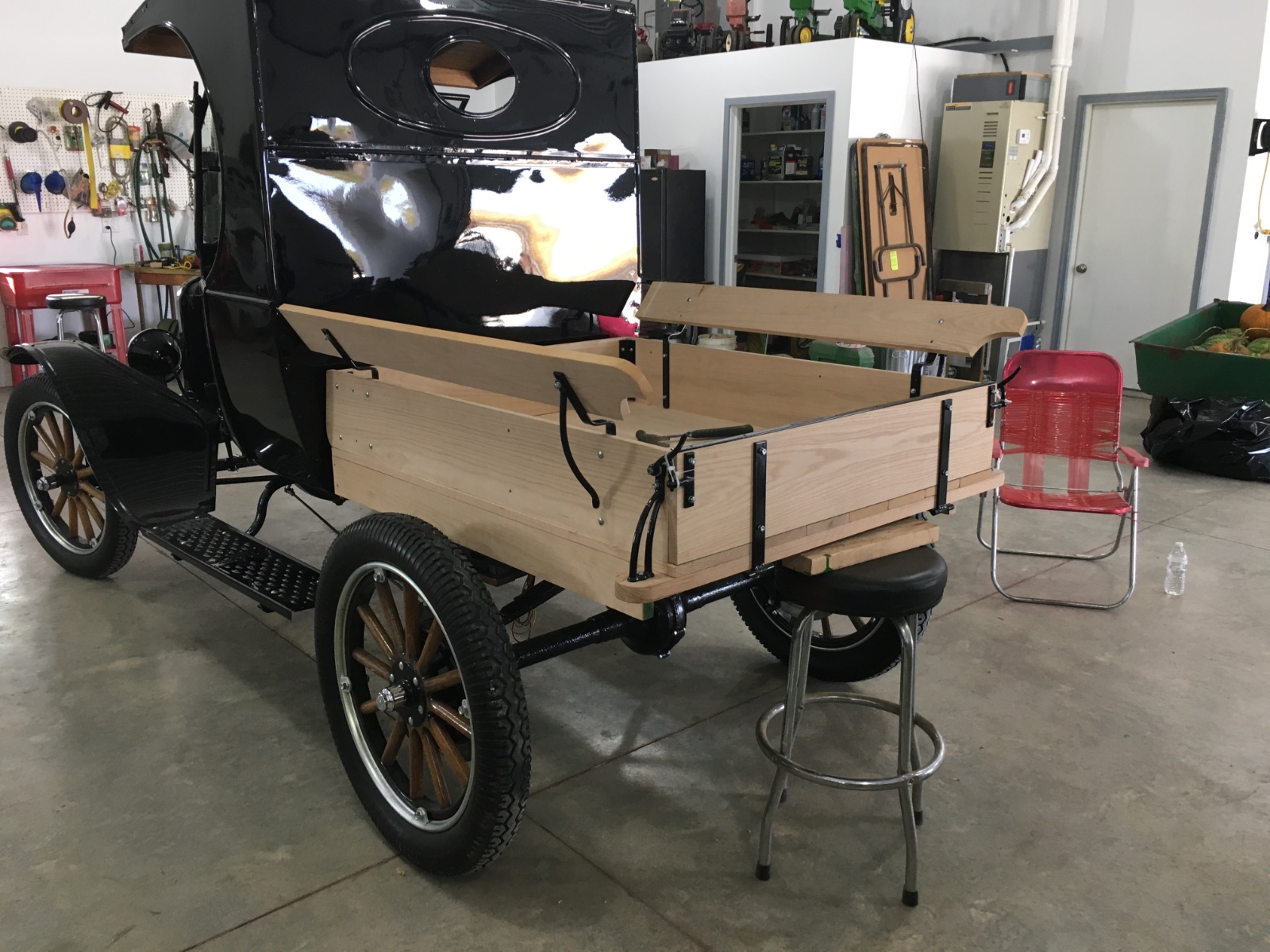

Re: 1925 pickup box
If you cannot find a pick up box, I purchased a wood box ( large size ) from Snyders. It's installed on a 26 car chassis. Some work involved with assembly & stain and finish work, but went together well w/ good results in the end.
