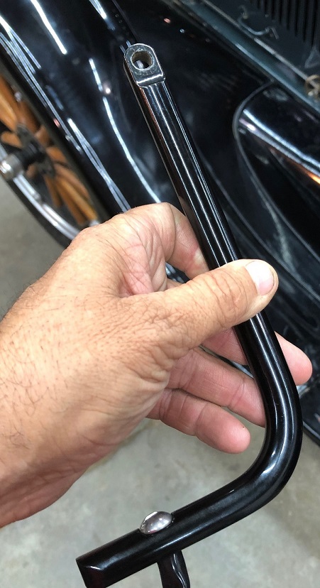

I'm a newbe on the T's. just bought a 26 touring. I am blind in on eye so I must have an outside mirror for my Indiana driver's license restriction. I purchased the heave mirror bracket from Snyder's that is different per year. I however cannot find the correct mounting holes for this bracket. Thus do I have a different year windshield? I thought about the clamp on style. But everyone say the vibrate badly and you can not see out of them. Any advice is greatly appreciated. Thx Steve

You have to replace the stud used for the lower windshield half with a longer version (maybe 3/4 inch longer). The bracket mounts counterintuitively, upside down. It is held in place with the lower windshield wing nut. I took mine off my car when I showed it for the Grand National. Sorry, but I don't have a photo of it in place on my car. Send me an email if you need any guidance. All the best.
