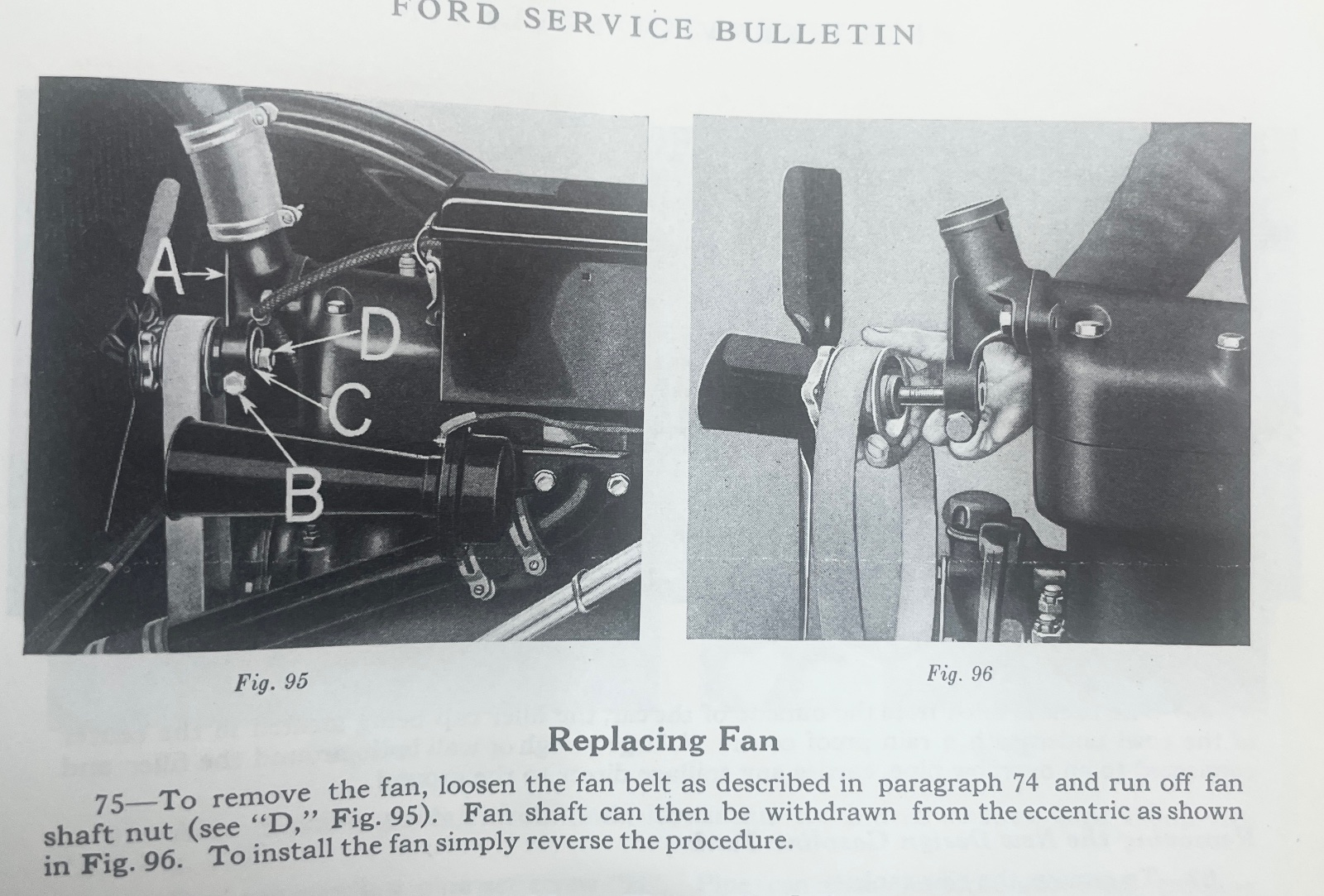

Bringing this thread back up again because right now I am trying to reassemble my early '26 fan hub (the one with the clamping bolt on the underside, short version).
I changed the fan blades and seal, cleaned everything up and try to get it back together like in the sketch above with felt seal and dustcap.
But something does not work. Whenever I tighten the nut the shaft does not move anymore in its bushings. The dustcap with the felt seal is pressed against the eccentric and the rear bushing.
The eccentric's hole (where the shaft goes through) looks like that there maybe has been a thread in it - but my shaft runs straight through without screwing.
Should there be a thread for the shaft in the eccentric? This would explain the problem. With a thread the shaft could be screwed into the eccentric until correct belt alignment and the locked with the nut.
Does anybody have picture of correct assembly?

The eccentric is not threaded for the fan shaft.
The drawing above is correct.
Note that the fan shaft sticks out further than the pulley end bushing. That provides the space for the felt washer.
The felt retaining washer fits tight to the eccentric & fan shaft, locking the shaft.
The bushings could be to thick in the flange or the fan shaft is not correct.

Strange.
Found an assembly picture here: https://mtfca.com/phpBB3/download/file. ... &mode=view
But for me it's same problem.
If I tighten the nut (3986) hard enough that it doesn't come off I press 3987+3982+3983 against 3974B.
In the end it can't turn anymore. What's the trick here?

Sean: Are both bushings fully seated in the pully? (Bushing flange undersides tight against both ends of pulley) If so, you need to remove some flange material from one or both hub bushings. Part number 3974B in this assembly drawing:
app.php/gallery/image/1124
Does the fan axle support, p/n 3988 fit squarely against the 'step' in the fan axle? If the hole is wallowed out the shaft may be drawn into the washer and that may also cause the symptoms you describe. All the best, jb

Even more weird: In all those 26/27-images the shaft is declared as 3966B, but in the shops the shaft with the recession for the wrench at the end is 3966C.
The early 26 does not have that support plate. There the dustcap seems to fit against the 'step'. But as it seems for me there's not enough space for the felt washer between bushing and dustcap. It is squeezed way to much. Maybe I will try a washer to make the thicker part of the shaft a bit longer.

Check that the front bushing is not binding on the radius between the bolt shaft and head. You may need to chamfer the bushing hole somewhat.

Here is the instruction of the 1st style or early '26 fan with the worm like drive eccentric using a special bolt from the Service Bulletins to help.
Have only experience with the later '26 fan and easy wrench adj. smooth eccentric.
