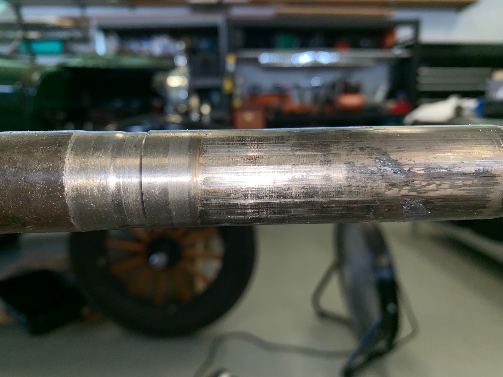

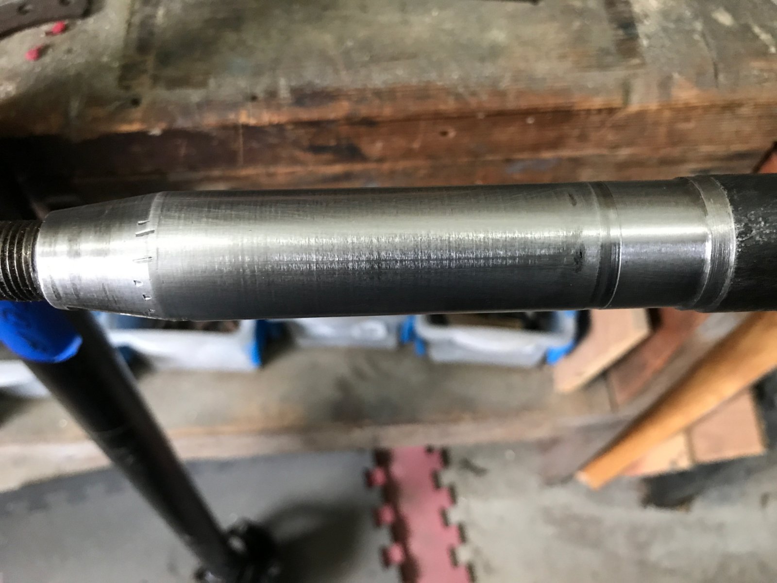

There is a groove on the driveshaft where the original style thrust bearing sits. The bearing, sleeve and Hyatt looks okay, but the pinion was “just” tight, I don’t think the sleeve was pushed deep enough.
In any case, I decided to go with the FP pinion bearing.
Is this groove cause for worry?
Second, the u-joint was worn, but not badly, but the sleeve was chipped and was installed with a thin outer sleeve “shim.
The socket in the drive shaft has a ridge.

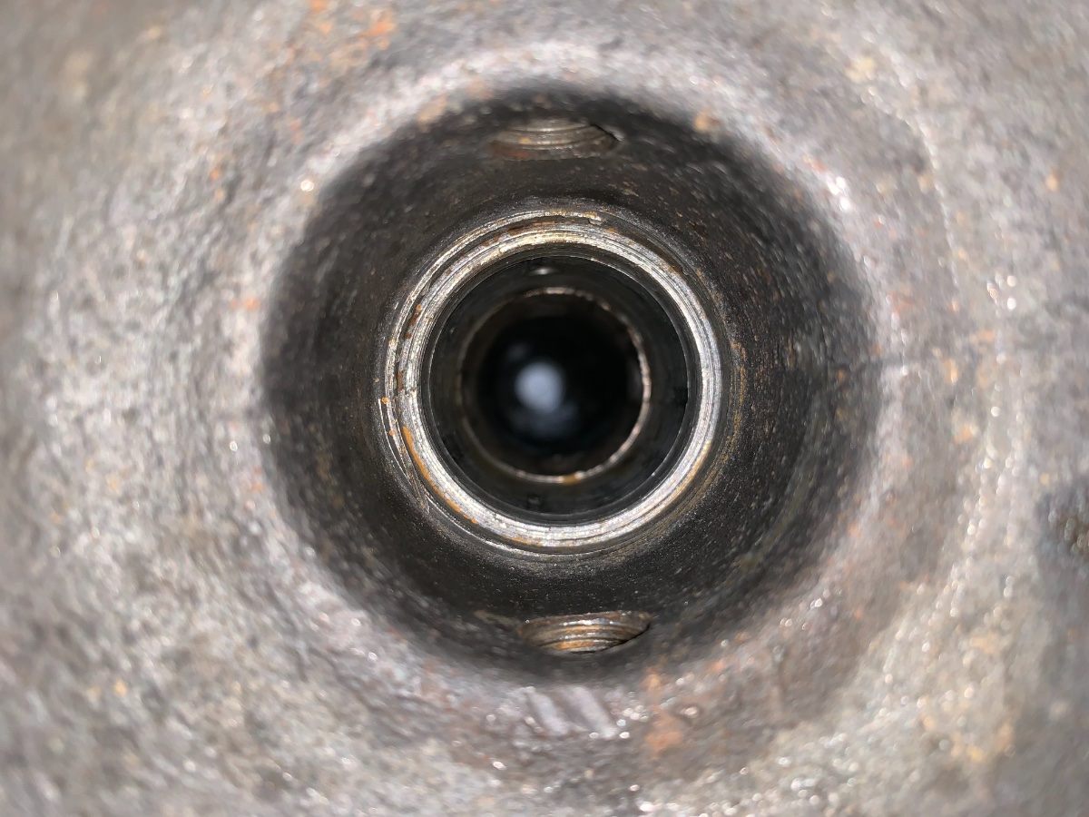

Pictures of the axle housings behind the bearing sleeves.
All four are scored and the one has a significant wear divot on the outer right. The sleeves and Hyatt’s look ok to me. I plan to reuse the Hyatt’s , replace the two outer sleeves.

I'm no expert but I had a similar groove and John Regan recommended I replace the shaft. I purchased a new one from FP along with the modern non-adjustable pinion bearing (also per John Regan). Hopefully someone more knowledgeable will chime in.
Posts: 3960
Re: Drive shaft questions
Post by DanTreace » Sun Jul 07, 2019 4:59 pm
IMO, replace that drive shaft, the cut groove is bad to have there, may be place for a break to set in. The drive shaft and related pieces attached take all the torque and load of going forward, reverse, and most important, stopping.
That bore wear in the axle tube may be from earlier wear of original sleeve, would replace all 4 sleeves with new quality higher priced ones. And new bronze bushing up front in the torque tube. Fun Projects modern pinion bearings are fine in my experiences.

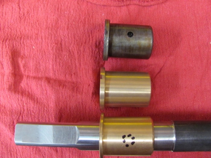

A new bronze bushing will measure 1.312" approx. You want a press fit so it won't spin.
So you could check bore, if i.d. is too large, order a new one for pattern, and have a machine shop turn a larger piece to match from bronze stock to fit.
Remember to add the hole for the grease/dope cup above.

The steel bushing that I pulled out was split, is that common or was that a mod?
I can’t figure why the bushing was split and still had a shim?
Posts: 3960
Post by DanTreace » Mon Jul 08, 2019 8:51 am
Certain that isn't the Ford way. That front bushing for the torque tube was original one-piece Babbitt bushing. Simple.
One could suppose the repair was made without a new replacement bushing; and that old worn bushing, with too much slop to the driveshaft, was split to reduce the i.d., and that shim placed to keep the now split bushing snug?

Most of the Original Ford driveshaft bushings were a plain split steel bushing that was babbitted.
Posts: 5439
Last Name: Gregush
Location: Portland Or
Post by Mark Gregush » Mon Jul 08, 2019 11:43 am
What Adam said. The steel part is not a shim, it is the shell for the babbitt. Like today's insert bearings.
