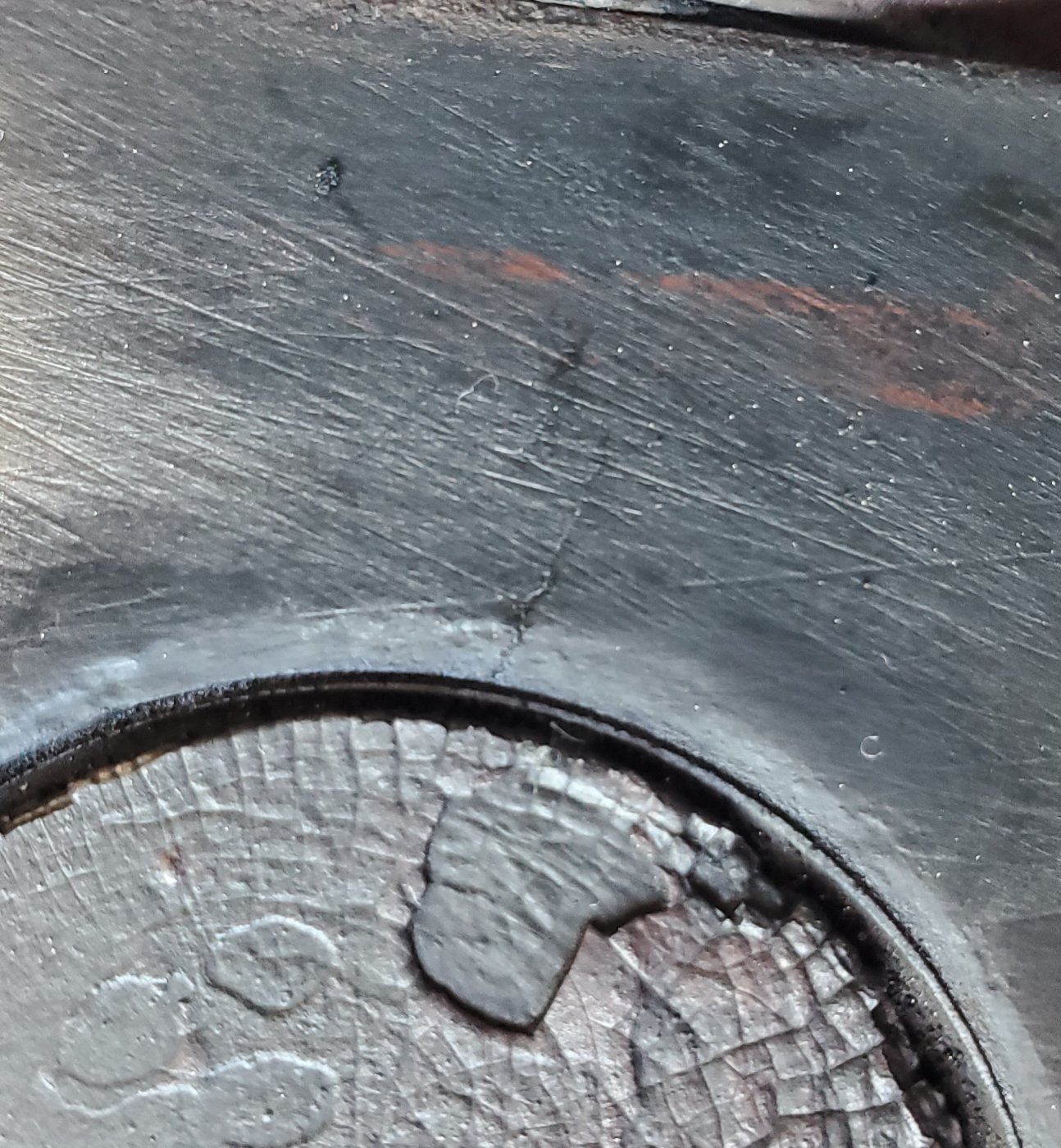

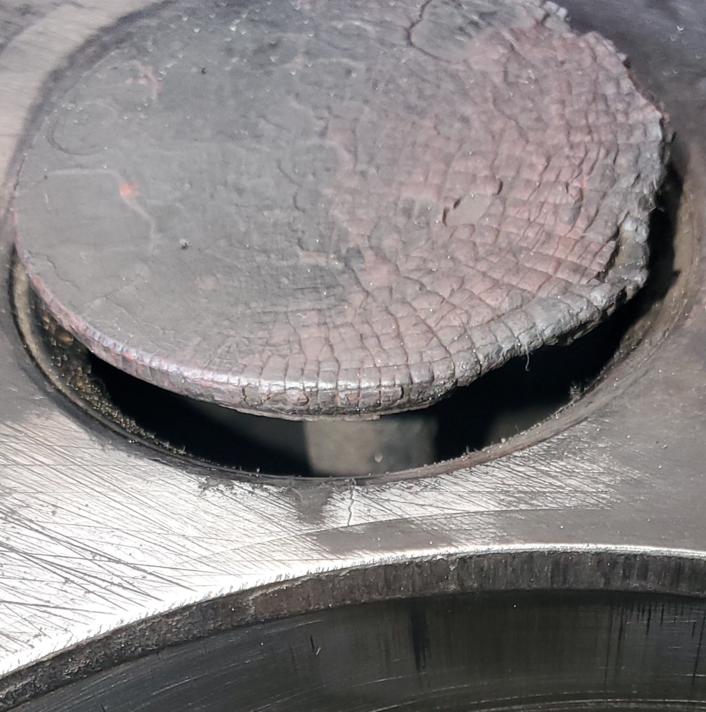

Valve seat, probably exhaust. On most engines, the exhaust valve seats nearest the center of the block or where two exhaust valves are adjacent to each other are most prone to cracking, but any of them can.
John_Aldrich
Topic author - Posts: 131
- Joined: Wed Mar 13, 2019 10:46 am
- Last Name: Aldrich
- * REQUIRED* Type and Year of Model Ts owned: 1915, 1923. 1927
- Location: Kapowsin WA
RVA23T
- Posts: 851
- Last Name: C
- Posts: 8632
Re: Water in the Oil
.....Perhaps the seats cracked due to running a lot of miles with leaking valves. Those valves are extremely burned, and the seats have been exposed to extreme temperatures due to being blasted by hot gases under high pressure.
John_Aldrich
YIKES! I'll take a look but my valves are in much better shape!

Chronic late timing, chronic lean mixture due to operator error or leaking intake gaskets, and poor seating due to too little valve lash or poor seating due to improper valve to seat fit will allow valves to burn or warp. Continuing to run the engine will cause the problem to get worse, and can lead to thinks like cracked seats, or lost valve heads on two piece valves. Detonation under load can occur with overheating valves, and if it does, it will rapidly accelerate the problems.
Carbon can also affect valve seating and lead to valve burning.
- Posts: 5526
- Last Name: Hatch
- Location: Alabama
Read Joe Bell thread. Can’t tell you how many I have seen cracked in valve chamber. Usually around the valve guide. Need to pressure test the engine to find. Good luck. Dan
