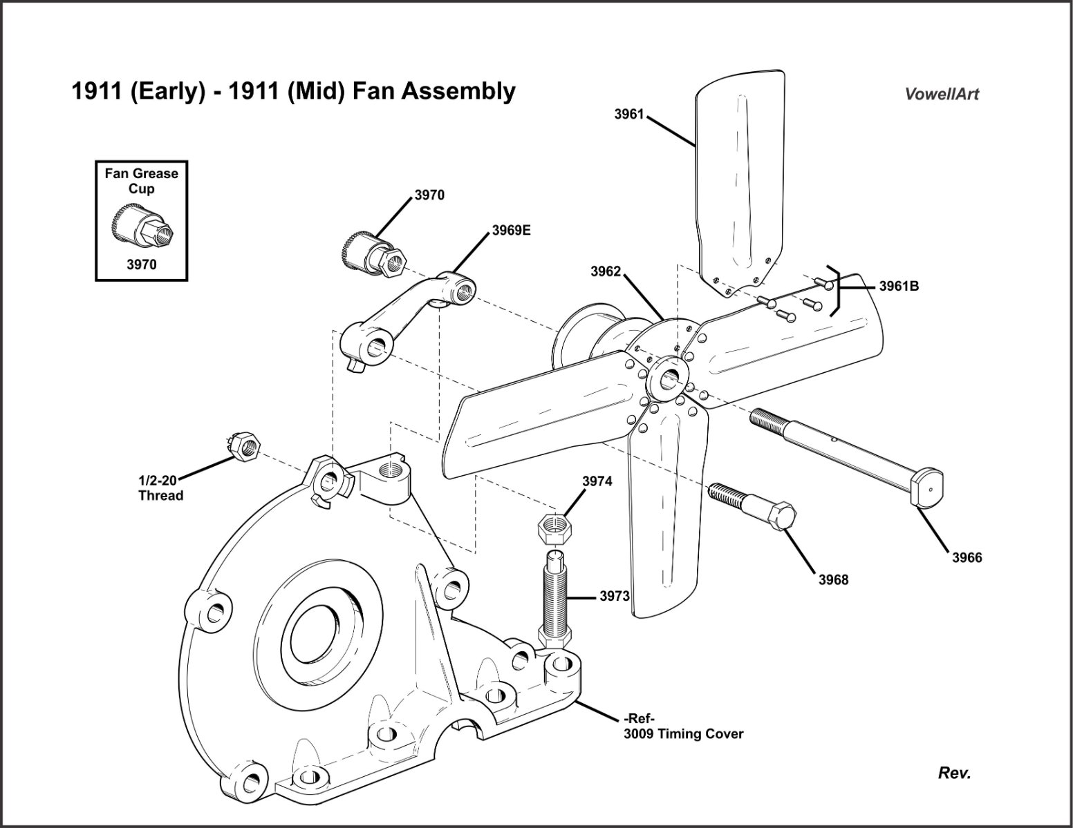

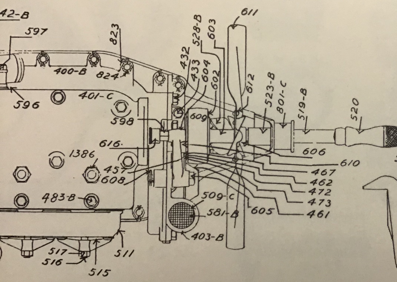

Post by VowellArt » Wed Jul 10, 2019 1:20 am
The parts list called out the nut for bolt 3968 (as nut) and it is drilled for a cotter pin too, yet there is probably no reason for this nut in the first place, since there is no stress or rotation other than a slight pivot of the fan arm and it goes through the timing cover and threads into the block boss on top, so I don't think there is any real reason for the nut and or the cotter pin, but I included the nut's thread size (since I couldn't find a part number for it) if you wanted to either install or replace one.
As always, if any of you see something not right, please let me know and I'll correct it as quickly as I can. :)

I’m not sure the method of holding the spring on the drawing it correct. I think my 09 has a pin to locate the spring where it attaches to the front plate. Of course I could be wrong or I may have forgotten. I can’t quite tell if the drawing of the front plate is for the one piece timer which seems to be used until the 1911 models.

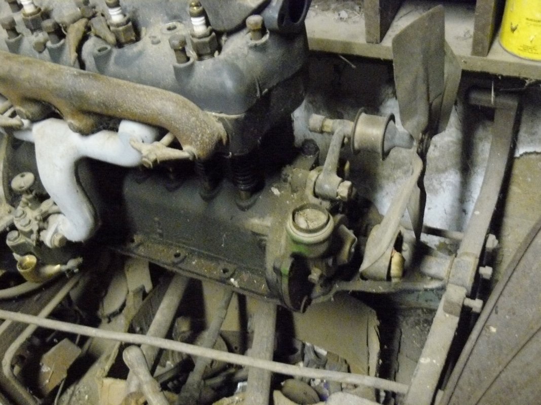

There are two basic designs of the early two-piece timer cover with the spring and then a third where the lug used a tension bolt. They were discussed here awhile back:
http://www.mtfca.com/discus/messages/82 ... 1519055307

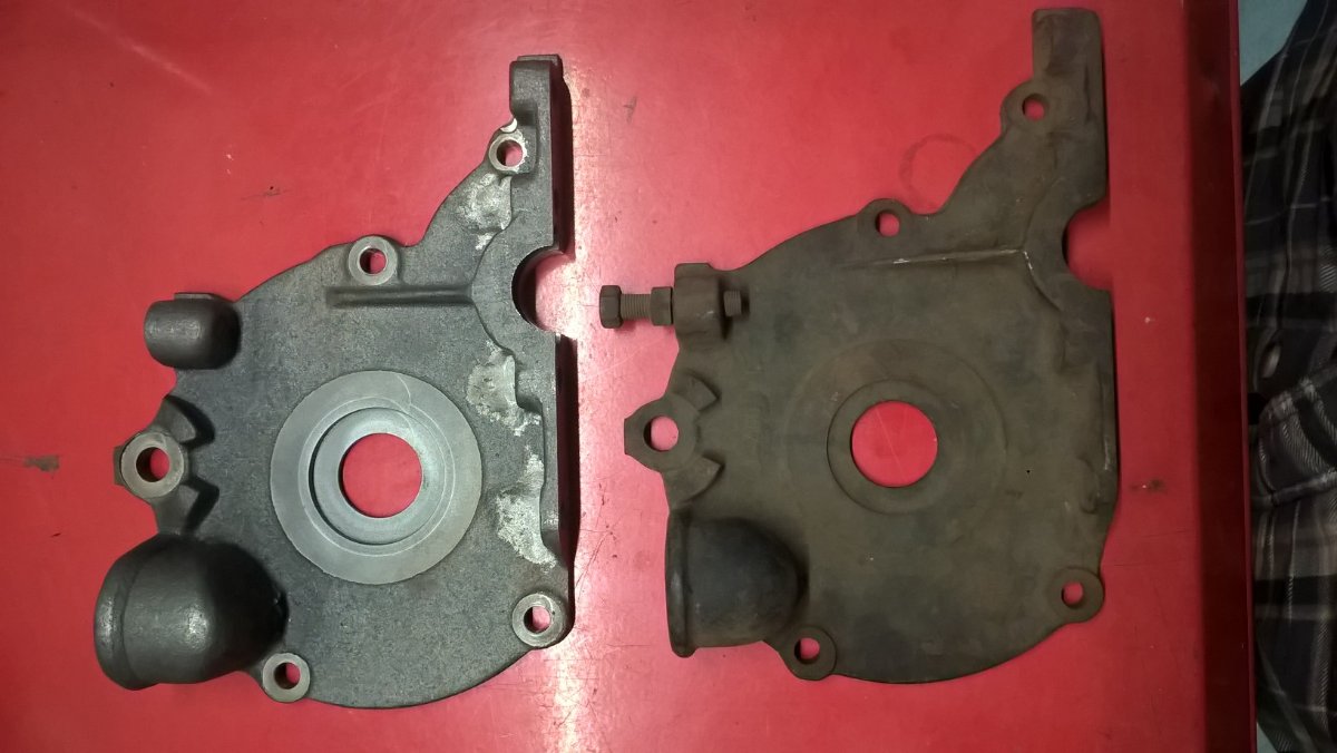

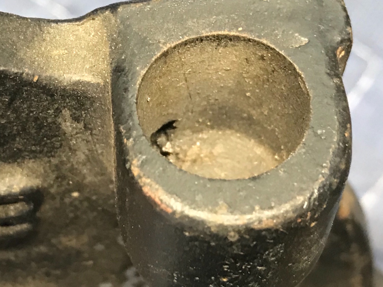

Post by TonyB » Fri Jul 12, 2019 12:26 am

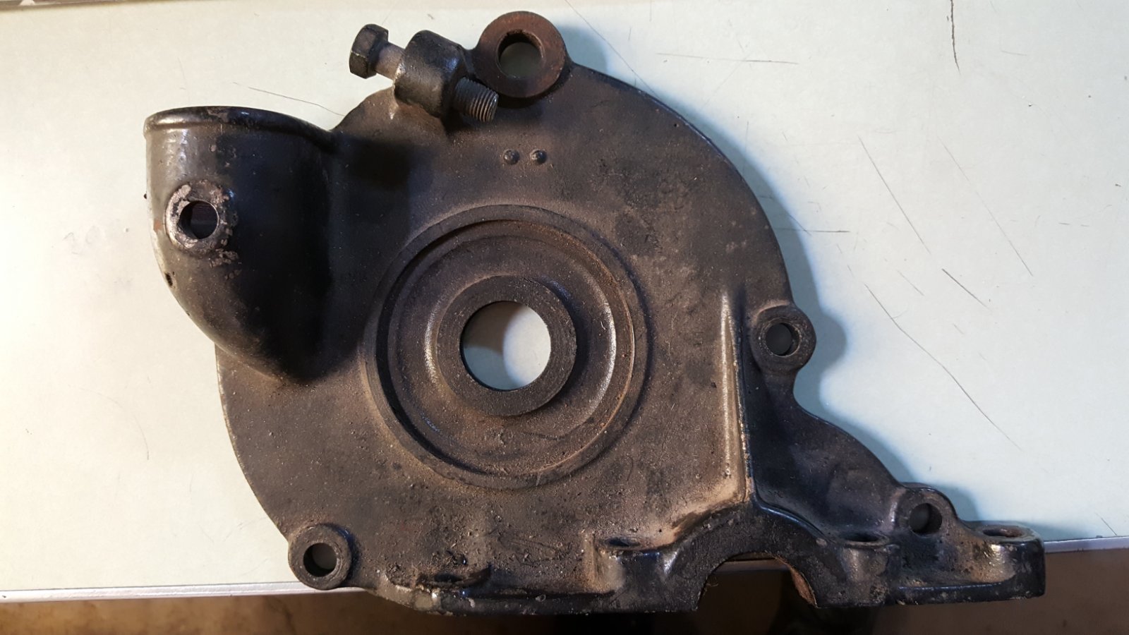

At last I remembered to take the phone to the barn and take a picture of the fan mounting on my October 1909 Model T Ford.
My memory was correct (for once), the plate has a pin to hold the lower end of the fan tension spring. You can see the pin through the coils of the spring.
Fan spring mounting
Fan spring mounting
So I don’t know where the idea of the hole shown in the drawing originates, of course mine could be wrong.....
Tony Bowker
La Mesa, California
Posts: 4084
Re: ***!909-1911 Fan Assembly***
Post by DanTreace » Fri Jul 12, 2019 8:55 am
Tony
I recall the earlier thread, now seemingly lost perhaps to the old server files gone? Used to easily google search MTFCA and FORUM and find lots of hits, maybe this is only a server issue and Adm. can fix. ;)
But the 1909 parts book shows sketch of the p/n3009 front plate with the hollow boss and no pin part listed, but maybe that pin/post should be there?
Early plates have the spring just nestled in the hollow boss recess.

Tony
the '11 I just worked on had the same front plate as yours...

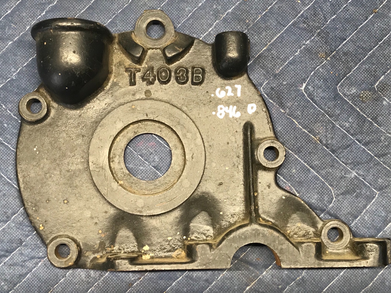

Post by KimDobbins » Fri Jul 12, 2019 10:57 am

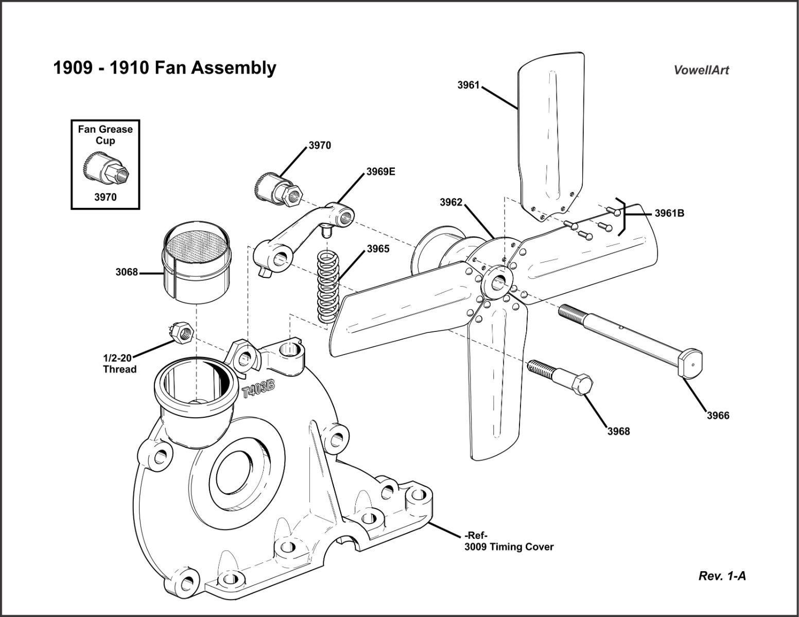

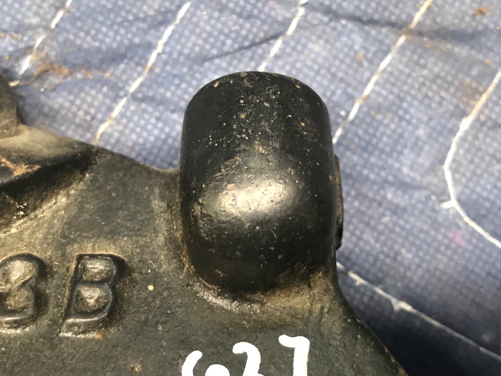

This is the 1909-10 403-B front cover used after car #2500. The 1911 cover has a stud and nut that is used to tension the fan.

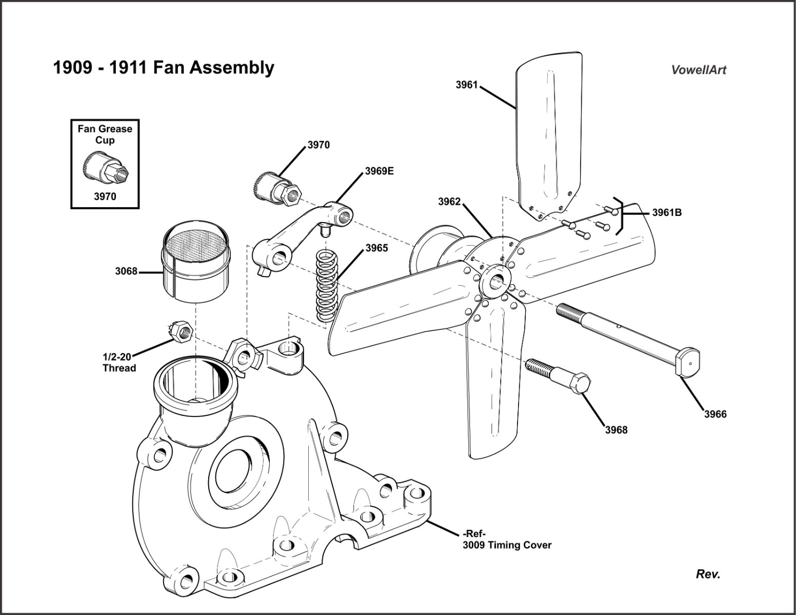

Post by VowellArt » Sat Jul 13, 2019 4:37 am
Hmmm, ok it is 1909-1910...how about this?
Would like to see a better picture of that timer. Because of the Mid 1911 to Late 1911, oil filler/timer, I might just have to do all the timers, at least on these early cars.
Fun never quits!

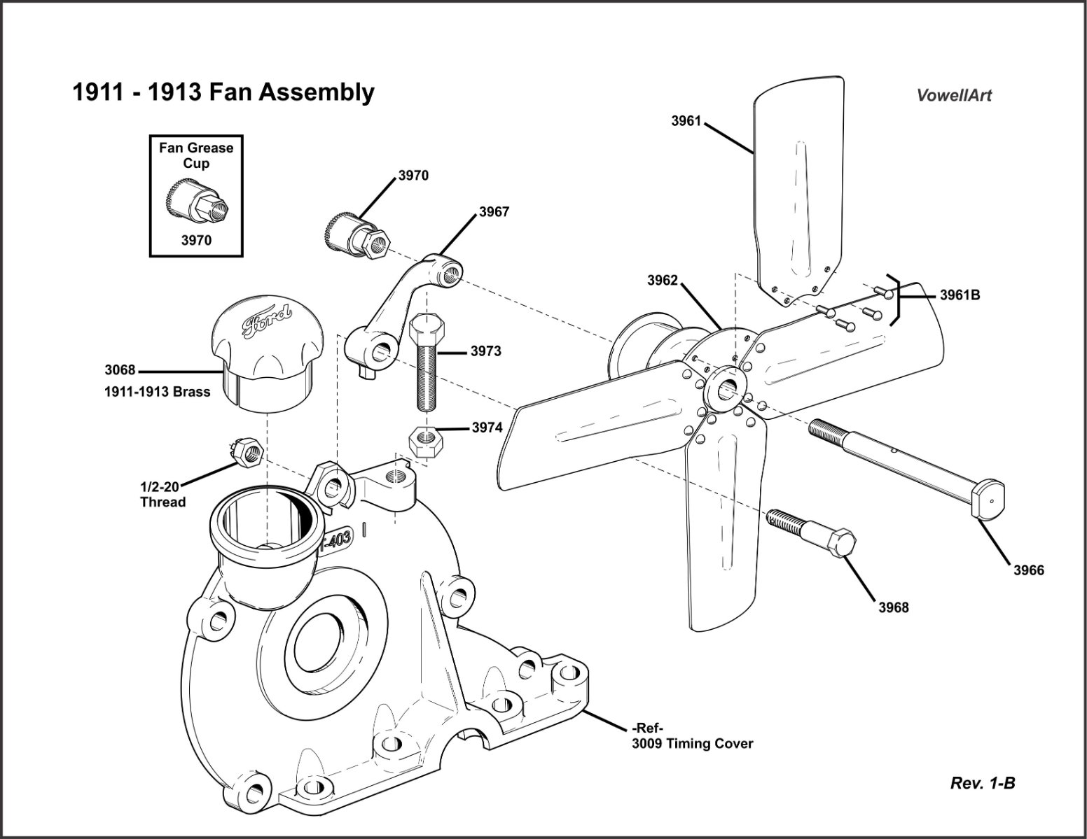

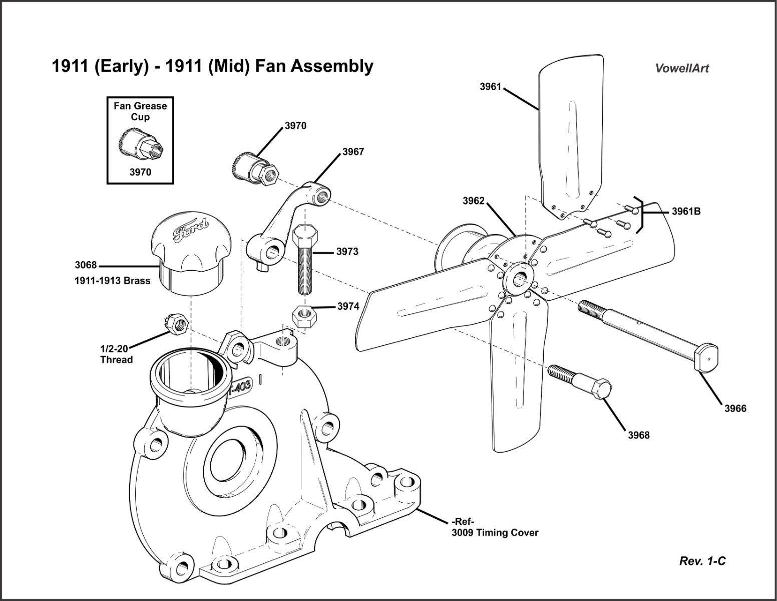

Post by VowellArt » Sat Jul 13, 2019 6:10 am
Is this correct for the 1911-1913?
because for a brief period in 1911 (6 weeks actually), they went with an oil filler on the timer itself, which proved to be a really bad idea and went right back to the previous idea with the stud/bolt and nut adjustment. In fact I think Ford had to recall all those with the Oil Filler Timer because the leaked oil everywhere whenever the timer moved (like advanced).
Fun never quits!

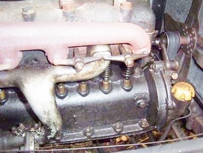

And this one which is the 1911-1911 Oil Filler Timer (which will be a separate assembly).
Fun never quits!

This is my photo from the previous thread. On top is a correct reproduction of the 1909 - 1910 cover that uses the spring and below that is an original 1911 cover that uses a tension bolt. Both of these use two-piece timers.
I don't think either of your two drawings above are correct. After the failed oil fill timer they went to the standard cover with the tension bolt pushing from the side, not the vertical bolt as in 1911. Also, I think the 1912 oil fill timer cover also used a tension bolt from the side.
Just for the record, I think it was decided that the problem with the reproduction cover that uses a pin protruding from the lug with the spring perched on top is that it affects the length and proper positioning of the spring vs. the one that sits down inside the well.

Wish I had seen that second photo before I posted those last two...I kept trying to figure out which way that bolt went from and was told that the bolt had a shoulder on the end that pushed against the fan arm...the one your showing here is directly opposite of what I've been told...I don't think you can get a wrench in the crook of the fan arm to turn the head of that bolt, but I don't know, these are waaay out of my understanding. Have you ever heard that the bolt or stud has a shoulder on it that fits into the crook of the fan arm or that the fan arm has a thick pad on which the shoulder of that bolt or stud pushes against?
Good to know about the 1912 though, I was wondering about that.

Post by VowellArt » Sun Jul 14, 2019 4:38 am
Ok, how about this one...I had to change the aspect of the arm, because it sat too low (I think I'll change all of them also, they all seem to be sitting too low and the bottom pin doesn't line up with the gap on the plate). Also made slight changes to the plate itself.
I'm still not sure of the date span though. Let me know so I can get on with the other fun ones...the 2 piece timer and the oil fill timer.

Post by Walter Higgins » Sun Jul 14, 2019 2:55 pm
The date span is just 1911. As you know, most things were not an exact model year change and I'm not sure if it went into 1912 a little or if the "1912 oil fill" caught on at the tail end of 1911 a little, but it wasn't used for the 1912 oil fill timer or again after the 1912 oil fill timer so far as I know.
