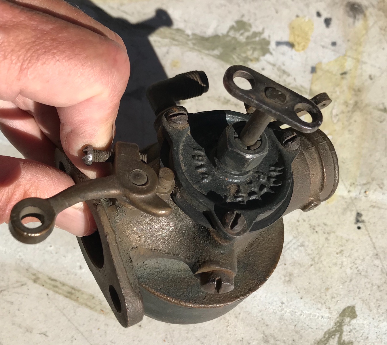

So I get a call today from the previous owner of my T “I’m closing my auto repair shop and I have a few parts I found you can have.”
I was there in an hour. Pics below of what he gave me. I’ve never seen these two carbs before. Perhaps someone can shed some lighting what they are ? I know one is a Zenith and very similar to my S4BF and the other is a Holley.
The tools all say “Ford” on them. No sizes are printed on them. The fuel pump is NOS and works!

Hey there Buddy - some of the tools are T, some maybe A, several V8 - the Holley carburetor is a G - electric start model - Zenith I'm not familiar with.

I thought the brass Holley carburetor was earlier than 1919 when starter equipped cars were introduced. By then the Holleys were cast iron. That two arm choke control on brass carby is new to me.

My first thought on the Holly G is about a '16. Then I saw the iron top with odd info (I couldn't quite read it). The two choke arms also indicate it was reworked at some point with some parts changed.

Is the top on the Holley iron or bronze? I have come across a number of bronze bodied Holley's with the same configuration; iron top bronze body. Too many in my OP to flat out say they were all reworks. I wonder if the bronze bodies were used longer then what has been suggested in the past.
