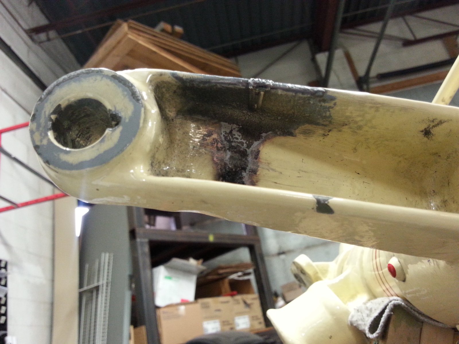

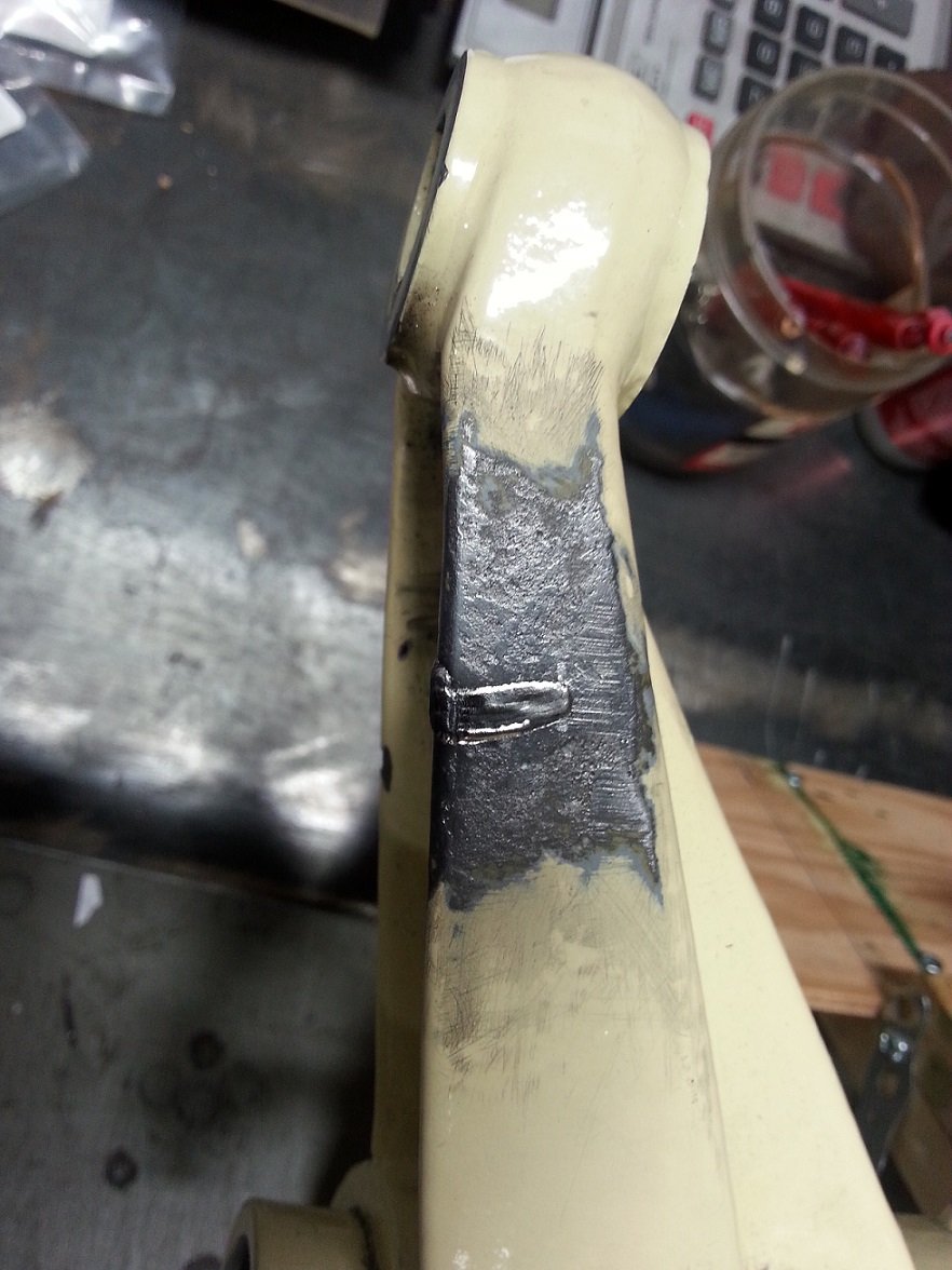

Can someone give me a recommendation for a person who can repair a small crack in an exhaust manifold port?
This is a 1909 Part T511. Thanks
See pics.[/size][/b]

Another option to consider. If the part is rare and you don't want to experiment on it. Consider looking up a "high end" commercial specialty welding shop that is set up for laser welding. I had a cast iron crack in an early Cadillac rear axle spider repaired by laser welding. It can be done with everything at room temperature, no preheat or post heat. And no distortion of the part. In my case it didn't even damage the paint an inch away from the repair. The cost was higher than a regular welding shop, but probably comparable to a good cast iron welding job.
The shop that did my repair in 2018 was one of only about 6 in Canada that was doing that type of welding repair at the time. Their main work was repairing specialty items like forming press dies, aircraft engine parts and other small but interesting stuff. The welding was done under a magnifying glass on bench and the operator was good at it. https://www.advanced-welding.com/index.html
I expect that there are more companies in the field now than were in it then.
Here are a couple pictures of the repair. The weld is about 5/8" long.
