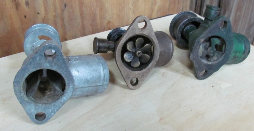

Here is what that 'Nims' brand water pusher looked like when new. A plug on the side of yours was the grease cup for the bushing, and a pulley ran a narrow secondary belt over the Ford belt to drive the impeller.

Ruxstel24
 - Posts: 2345
 - Last Name: Hanlon
 - Location: NE Ohio
Re: Water Neck Question
Scott, I have several improved style water outlets, with nice pullies. Send me an email if you're interested.
