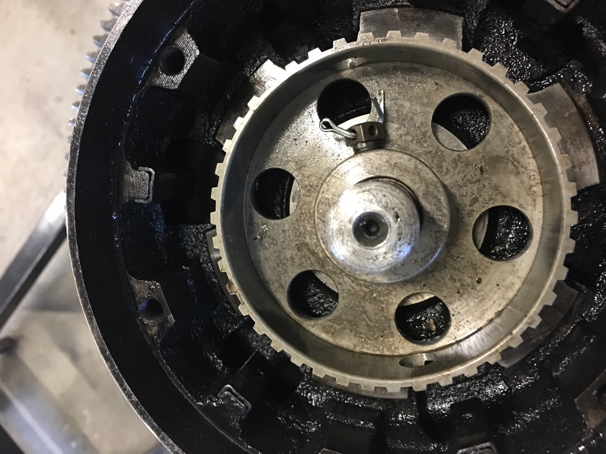

Hi, I just finished my frame off restoration after 8 years on my Touring 1911 and I face up issue with my Turbo 400 I bought at Lang's. I tried to correct the problem without success no matter I set up the 13/16 correctly and then measure the spring length at 2” then the clutch look to stretch . The 13/16 is correct and the spring is at 2”, maybe I need to remove 1 disc to allow less pressure? Hope It can be fixed without removing the motor according to the Ford handbook .
Regular first 2 disk look pretty good when I installed them. If I try to move the Hand crank without jacking the car, the car moved forward. If I jack the car, rear Wheel moved either. Not able to move the car itself without dolly. Look I'm in the high gear all the times. It is my second times I installed Turbo 400 and On my first car I never face up this kind of challenge.
Any suggestions or thoughts before removing this engine and transmission because it is not an any task... And I'm afraid to damage my new paint. Here bellow transmission picture and also my car.
I'm a bit discourages.
Kind regards,
Mario

I just opened my transmission, and I have exactly 1 1/8" tall... Previously I followed the Modern turbo disc instruction for 1916 and later because I used a 1926 transmission. I installed 2 large discs in the brake drum and alterning the 400 discs with Large discs and ending with 2 large Discs. Maybe, I'm better to finish with one disc to avoid my problem having a transmission stuck in high speed?
All old large discs were in good shape no cracks and wrapage, My spring is brand new either with 2'' height. Also I have the 13/16 space between the bottom of the push ring and the flange of the clutch cover
Any thoughts?
I will try to post pictures.

When I said '' I just opened my transmission, and I have exactly 1 1/8" tall it is all discs together. When I made my measurement from the bottom of the Iug, I have 11/4'' height as you see in the picture. So which measurement is the right one?

Correct it is the stack of clutch disks that will be 1-1/8 for the 26/27 drum you are using, not the drums them self. The 13/16 is a starting point for adjustment, not the final. Have you checked the strength of the spring? While not the best it can be done on a bathroom scale. Put the spring on the the scale and press down to where the spring is 2 inches tall. The reading should be at least 110-115 or better. It would be better to use a spring strength scale but will work in a pinch.
Unless the replaceable lugs are gulled up, 2 on top and 2 on the bottom would not matter or any combination as long as there is at least one large disk TOP and BOTTOM and =s 1-1/8" stack.
The early spacer disk was three disk thick.

I was able to start for the first time my 1911 touring after following all instructions. Sound magical. Thank you all for the input. MTFCA members were awesome. I will try to post a quick video, she run smooth as well
