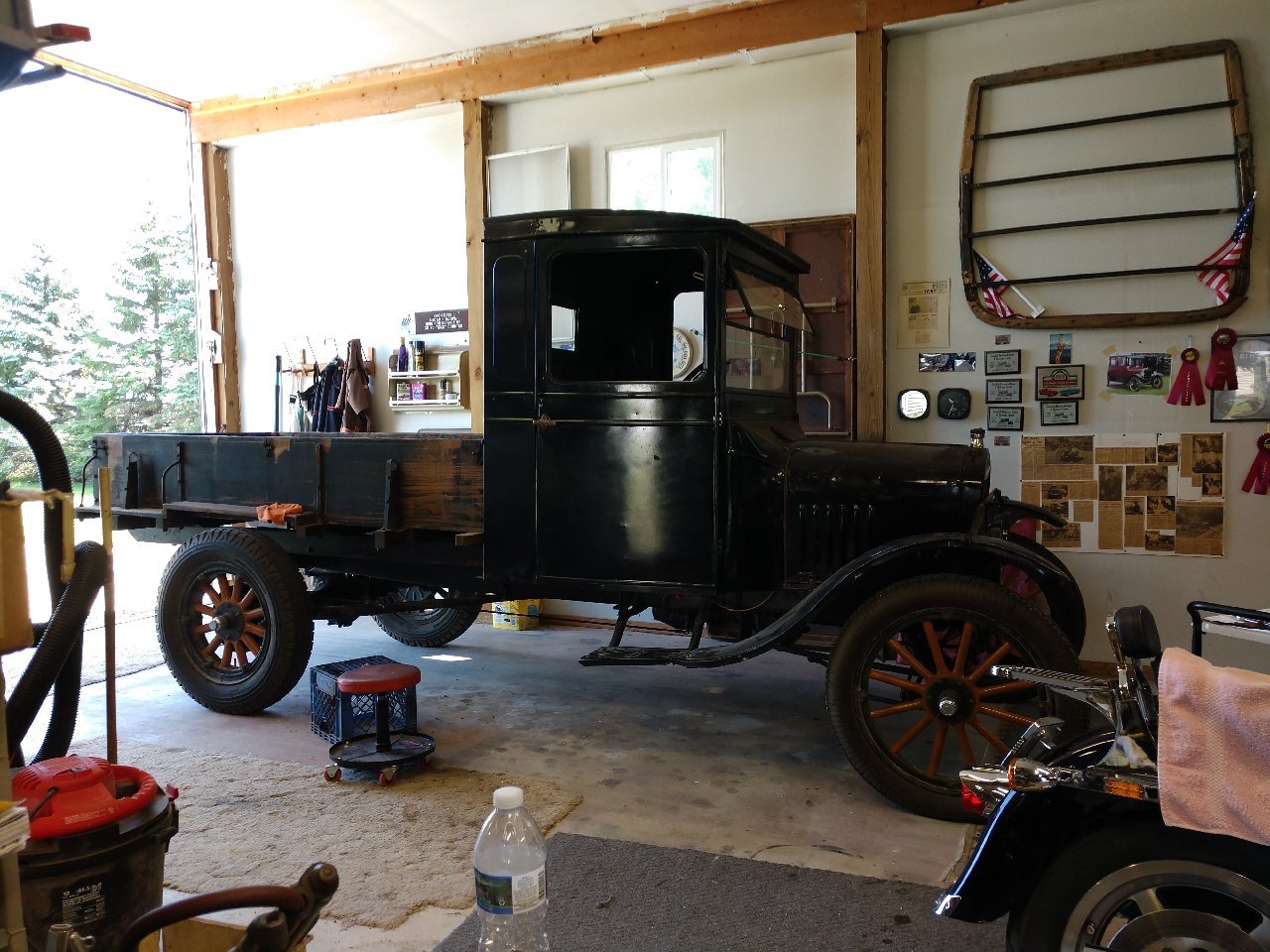

A bit different kind of wood work. 1926 TT
So the mission is to put some real strength back in these old boards. The termites had a feast but this is a historic grain box from Iowa and the repairs can't show. Should be a fun challenge!!

Re: A bit different kind of wood work. 1926 TT
Thanks for the kind words Scott. The bugger of this is the holes. Normally I could heat the wood and saturate it with WEST Epoxy. The termite holes have thrown a kink into that method. The epoxy would run out the holes and make a real visible mess. So, I'm trying to figure it out and it might take a "hole" different way of thinking..
Looks like powder post beetles got hold of it. That epoxy is great stuff.
